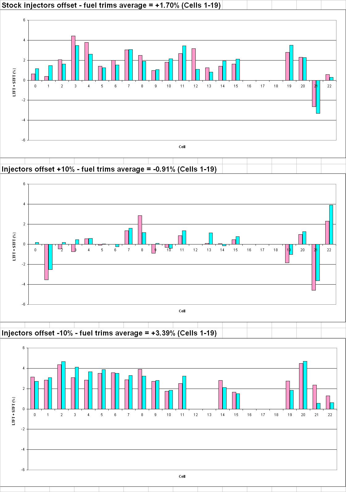

Here the results:
0% offset change (stock) => Fuel Trims = +1.73% (FTC 6-14) and +1.70% (FTC 1-19)
+10% offset change => Fuel Trims = +0.14% (FTC 6-14) and -0.91% (FTC 1-19)
-10% offset change => Fuel Trims = +3.12% (FTC 6-14) and 3.39% (FTC 1-19)
The fuel trims values are a sum of LTFT and STFT (this to give a more precide result).
I averaged the counts and not the cells, so those numbers are a weighted average and give the real pictuer of the thing.
The change in the fuel trims is pretty logical.
With +10% offset the car feels stronger while accelerating ant the engine reacts quickly.
With -10% offset something is strange... it's not too bad but it's like an old car with a compression problem. A little asleep sleep
Any comment? What else to try? The result with +10% is really interesting!

Here the results as a graph

I would do tuning tests with both -10 and +10 as to injector IFR table and see which one you like best.

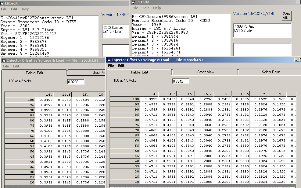

Looking at a 1999 and 2002 Fbody you see there is offset value differences

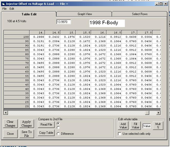

Here the 1998 F-Body delay table, which is pretty different than the 99 and the 02
