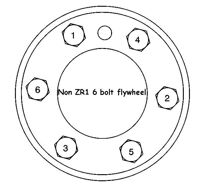

#2832 - 10/10/08 06:35 PM Re: Part numbers for LS3, LS7, LS9 clutch, flywheel, master, slave [Re: teamzr1]
Posts: 6,002
Posts: 6,002
Difference of LS9 and other C6 flywheels
It might be workable to modify LS7 to fit other C5/C6 cranks.
