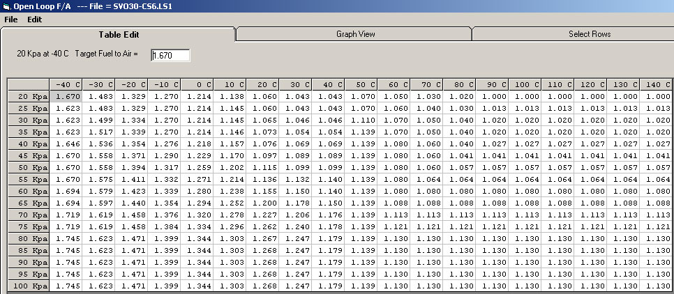

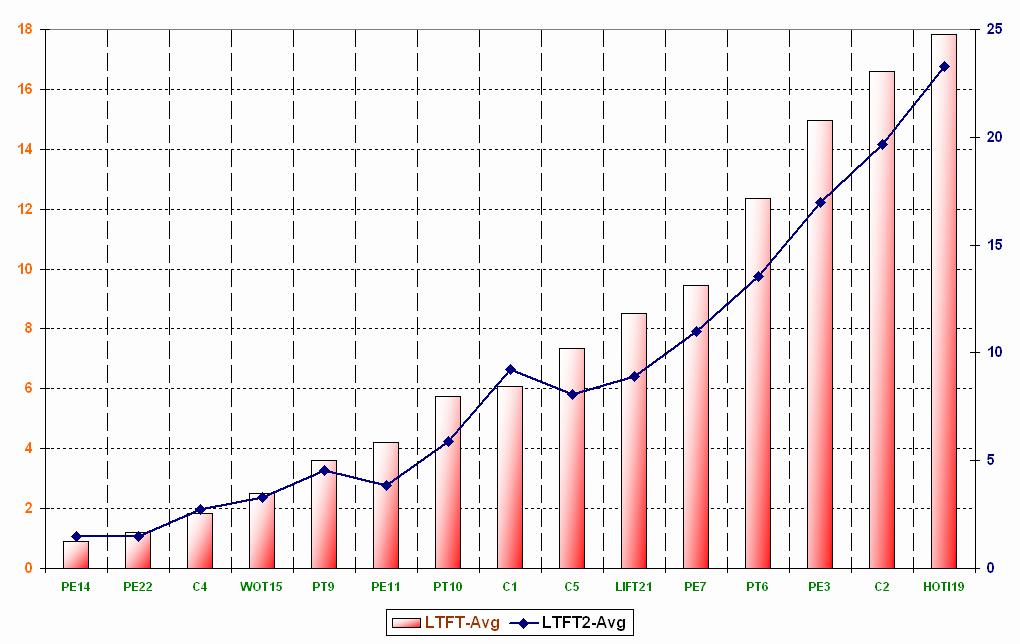

This testcase was about seeing how much different fuel injector brands require a different time delay set within the PCM injector offset voltage time table and air/fuel multiplier table.
Installed in our 1999 C5 372 stroker engine was the GM C5R 42 lb injector. The fuel trims cells were right on at about 0% readings for the long and short term fuel trims
Thanks to teammate Mark D for donating his used SV030 36 lb injectors that we swapped in with the C5Rs.
First we did a tune making the injector flow with the difference of using stock 28 lb GM injectors to the 36s.
You see from the results in doing so the fuel trims were way too lean due to the makeup of this stroker engine.
We then made fuel flow changes in another tune to make up for that but fuel trims were still a bit too lean and testruns showed engine was sluggish.
We analyzed all the OBD data and then made changes to the injector offset voltage and air/fuel multiplier tables and tested that to find the internal coil of the SVO30 injectors required more delay time for the coil to react.
We the proper values put in those tables as you see those changes alone caused the fuel trims to get richer, the engine response times were better and the fuel mileage bettered by 2 MPG.
You also notice as the offset times were set to more suit the injector that the left/right fuel imbalance decreased
This clearly shows not all injector coil reaction times are the same and must be factored in when changing injector brands.

#2804 - 09/29/08 08:03 AM Re: Injectors offset voltage times not created equal [Re: teamzr1]
After allowing the PCM to relearn over a few days driving we see in the only changes made was to the injector offset table that before was high lean conditions causing more fuel use and now fuel trims about perfect with a 2 MPG increase in saving fuel costs.

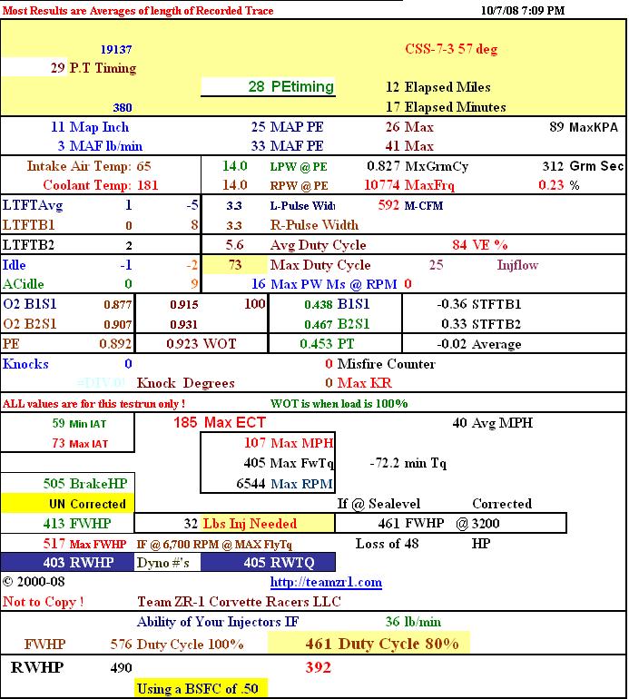

#2816 - 10/07/08 06:04 PM Re: Injectors offset voltage times not created equal [Re: teamzr1]
Final test results on this project after another week of driving and PCM settling in on it's adaptive strategy
You notice that the fuel trims have remained around a perfect zero for both long and short terms.
Also the injector maximum duty cycle was only 73% and in this testrun flywheel horsepower was 461 yet the math shows for a 36 lb injector that would have been at the same HP thus data shows that the maximum injector needed in this run was 32 lb/hr.
This gives a pointer to how much the water/methanol injection and our smart 3D controller reduces the load on the injector and to increase fuel mileage.
