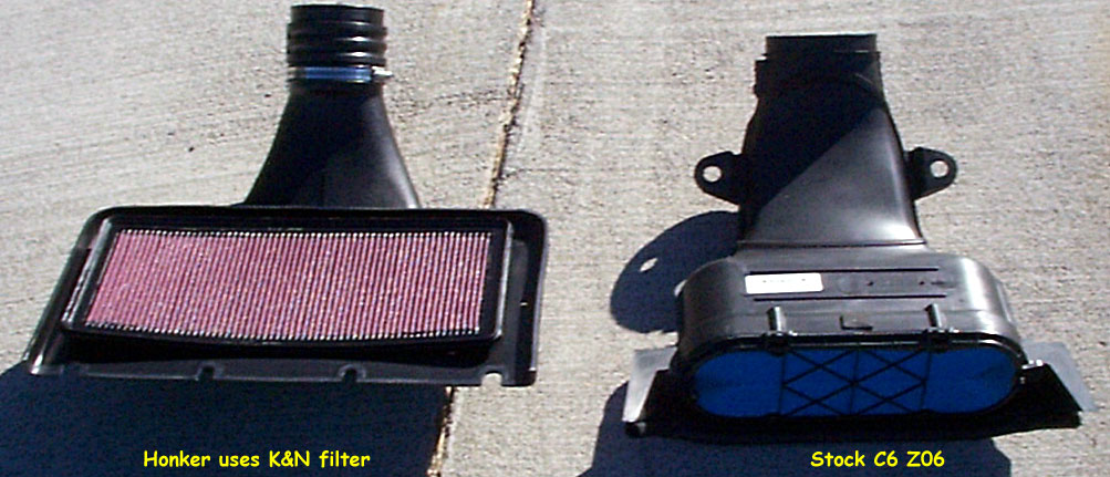

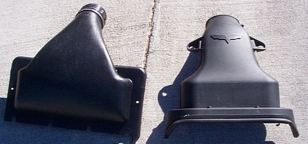

The end if the airbridge then is to connect to their MAF coupler that then connects to the stock rubber piece to throttlebody. mad
That end was out of round and was hell getting the coupler on.
Images below show all that and what the stock and honker look like plus how the honker looks when installed.

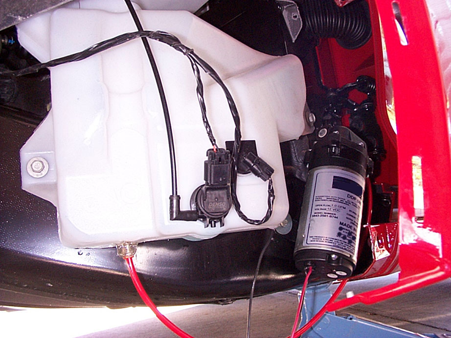

One image shows the install of our HIGH PSI w/meth pump and how all the fluids on any C6 is jammed together on drivers side.
