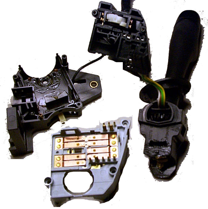

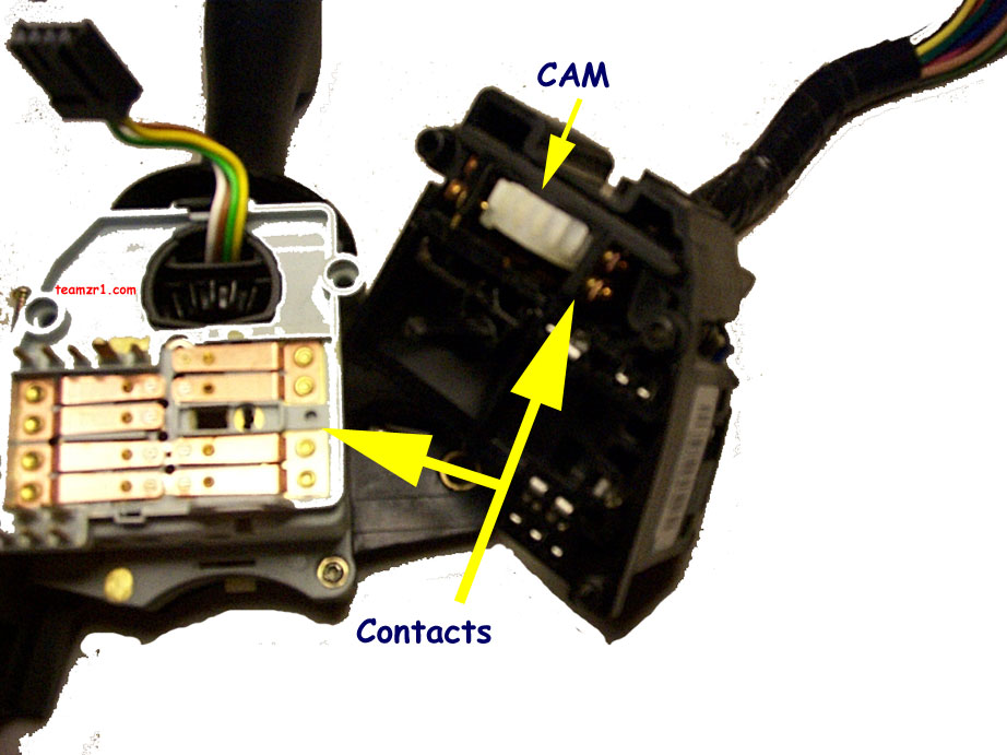

Common is for this module to fail. If care is taken you can take it apart and fix it.
As seen there is a lot of contacts inside and may be possible one is out of wack or dirty else the white CAM could have a tooth broken or the CAM has mis-aligned to the shaft it rides on.
There is only 3 screws holding the main control to the base and then 1 screw holding the contacts to the base
