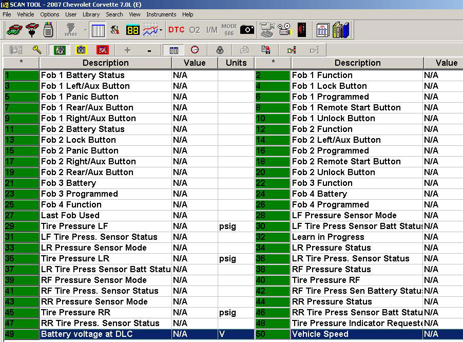

For those who own our OBD-II scanner and either have Level I and 2 ( or contact to purchase it) which allows connecting to other modules in the C6 then make use of the RCDLR signal set and you can see all that is going on with the tire sensors
This will tell you what state and mode the sensor(s) are in, what pressure is reported and even what state then internal battery is.
