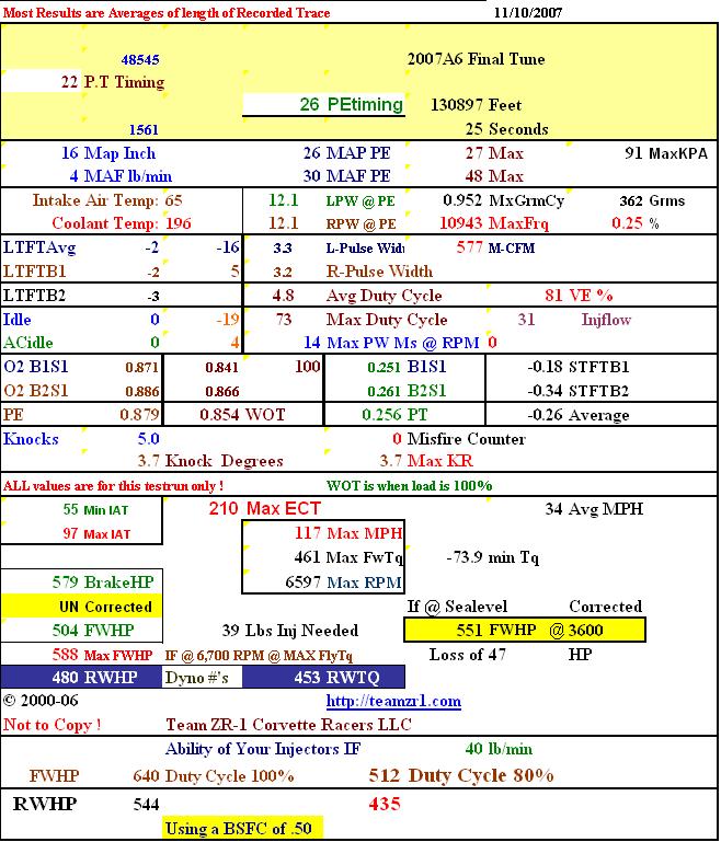

Here is results after all the clean up :

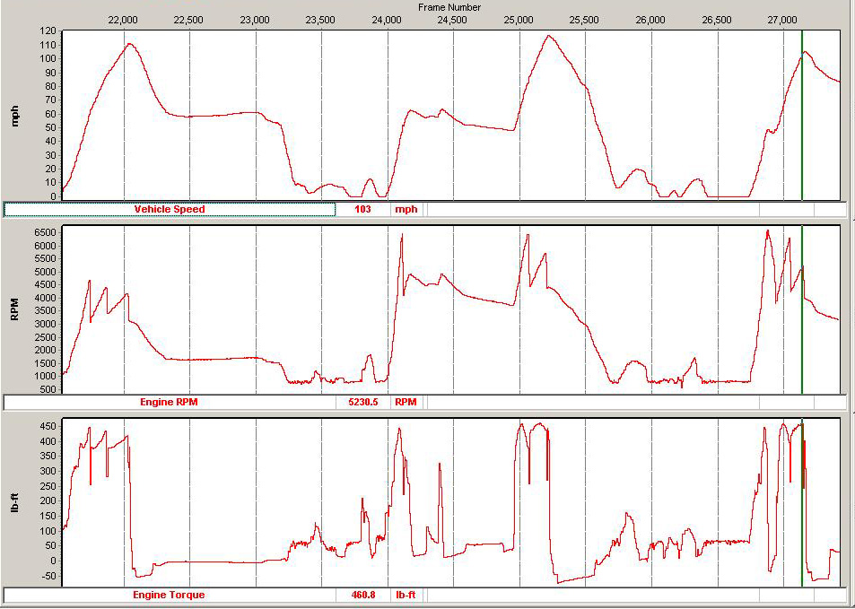

Here is scanner data of 3 pulls where I let A6 auto shift,
using the paddle shifter and holding RPMs per shift and fast shifts using paddle shifter.
Look at the torque values as when and when not torque was lost either due to shift times or wheel spin

Here is a good example when the wrong selection of CAM grind
Stock 2007 C6 on the bottom of these collected scanner data traps.
Notice this modified 2007 ( top data stream) mentioned in this thread how much vaccum is lost at idle and thus a domino effect to all other engine functions.
Compare the functions and their values.
#2107 - 11/12/07 05:16 PM Re: LG Motorsports [Re: teamzr1]
Posts: 5,984
Posts: 5,984
Here is where mods make an effect and that is at upper engine loads.
The mods itself would be useless without a good custom tuning as you notice the modified 2007 C6 has higher timing due to the tune.
Notice the torque and horsepower flywheel levels
