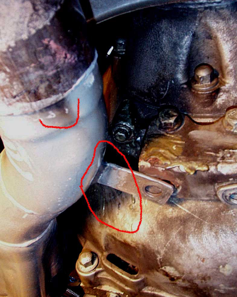

#2939 - 12/26/08 10:20 PM Re: Team ZR-1 Smoker [Re: teamzr1]
Posts: 5,939
Posts: 5,939
Design could use a fan to move the smoke or best an air compressor which allows controlling flow via PSI.
