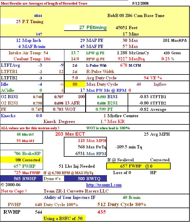

Here is the results of a 2008 Z06 with a custom CAM installed and our first cut of the custom tune.
With this data we will now tweak the tune for bit lean WOT and bit rich for other engine conditions.
Almost no knock even with 27 degrees WOT timing and no rear misfires.
At the worst owner needs to consider bit larger fuel injectors since duty cycle peaked at 88% in 55 degree weather or install our smart 3D smart water/methanol injection.
