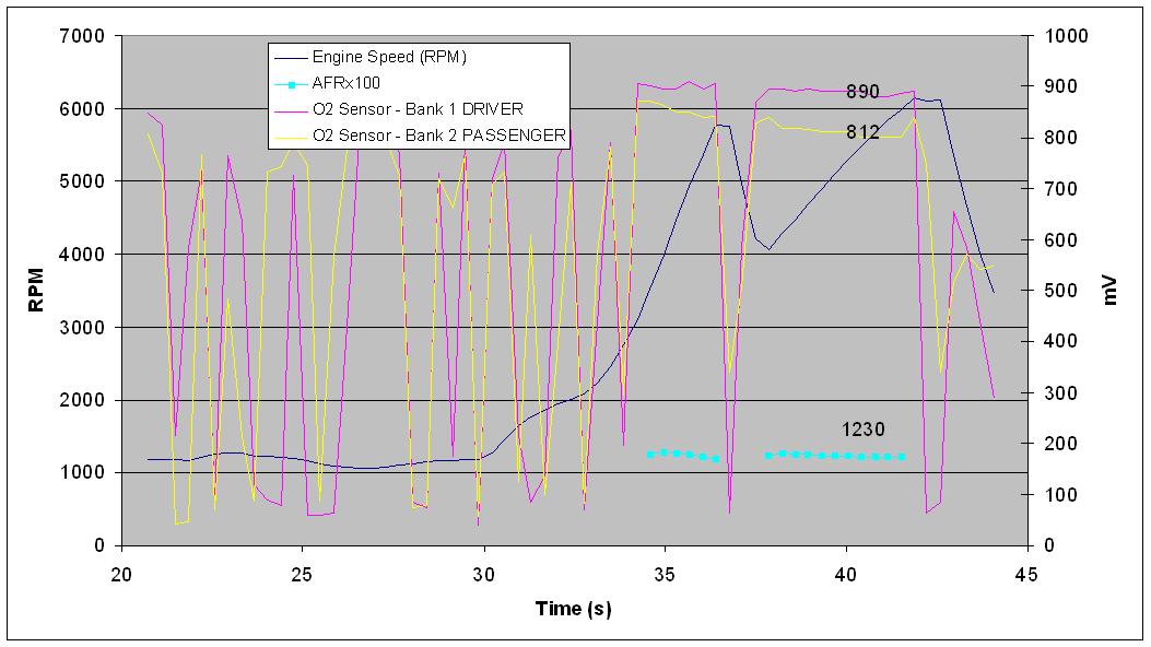

This is a short PE scan I made of my 98 Trans Am (stock LS1 engine).
Notice the mV differece between the banks.
The light blue line is the AFR measured with a WB installed just before the passanger side catalyst.
In CL both banks have +/- 0.5% the same fuel trims so now I'm surprised to see that in PE the sensors show different values.
Should I care about that? I know the stock sensors are fine just for CL operation, but I was thinking they would show more or less the same values in PE.
Notice also the smaller difference at lower RPM (around 3000 rpm). Is it possible that a mechanical reason causes the difference? Like a damaged lifter or pushrod? A weak spring? Something that isn't working fine only at high RPM?

The difference of 812 mVolts and 890 is only a AFR difference of about 12.7 to 12.5 AFR so not that far off.
Both sides of engine exhaust makeup rarely are equal
Add long tube headers and many times one O2 is at a different distance then the other sides O2 thus one reason for reported difference.
Cannot speak on that one wideband O2 as what it reports but again kinda half an answer since other sides exhaust has no wideband and what it reports.
PCM of course ignores the O2s for WOT but also the PCM only reacts to O2 values once a minute so a captured scanner recording of 45 seconds might not give a true AFR rate from 02s.
It is hard to see the lines in graph due to line colors and gray background but it seems once above 4,000 RPMs which is where PCM stops looking at MAF and more to VE that imbalance seen clearly.
It seems both have about the same switching rates, sometimes one head has better flow and thus imbalance seen as the exhaust rate speed up.

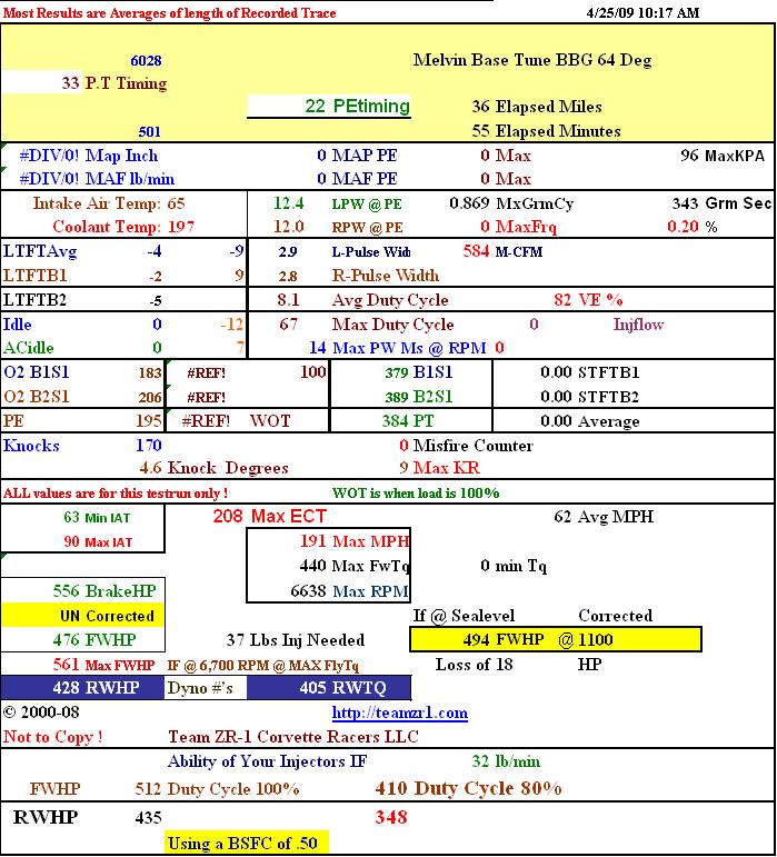

Here is a 2008 C6 of Melvin's who is at the USA base in Germany I just tuned this weekend
He was able to pull 192 MPH on the highway and gained about 50 HP with just a tune so LS3 is a strong engine
