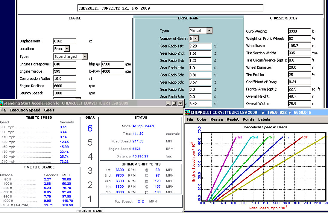

We took the data of the new ZR1 and did simulations to see how it performed.

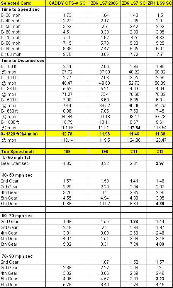

Then we added the data for the new supercharged Caddy CTS-V, a stock LS7 Z06 and another Z06 with a supercharger added to it to benchmark the 4 with the results below
