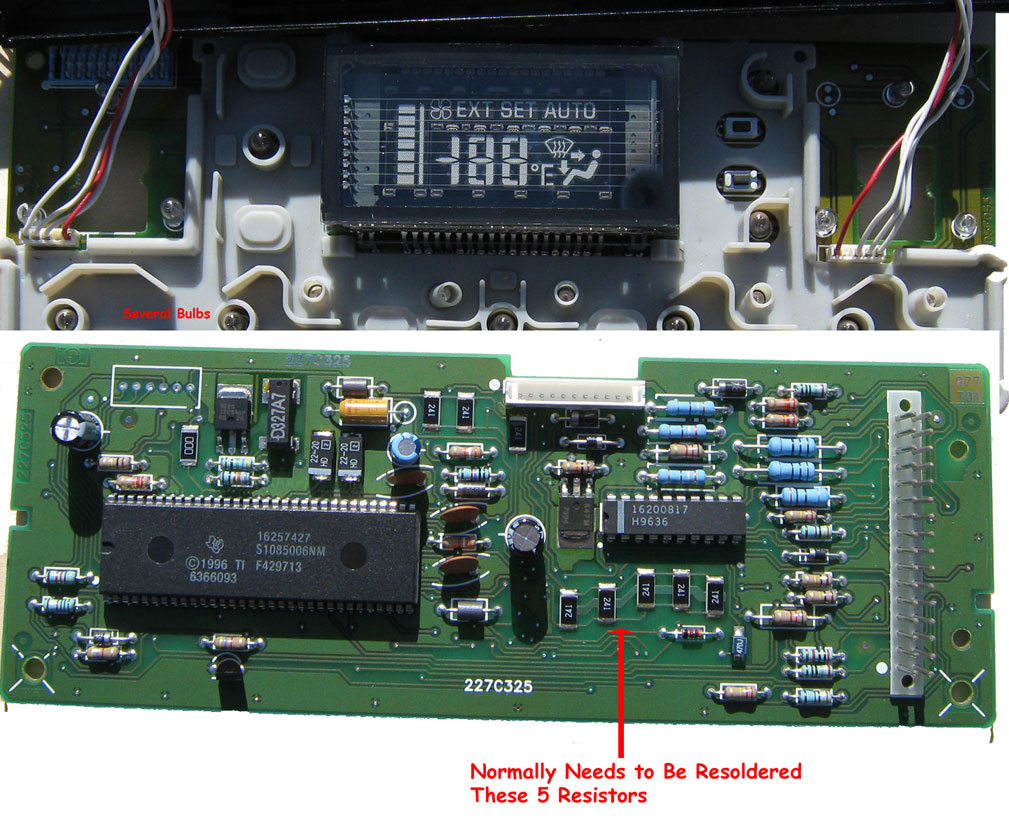

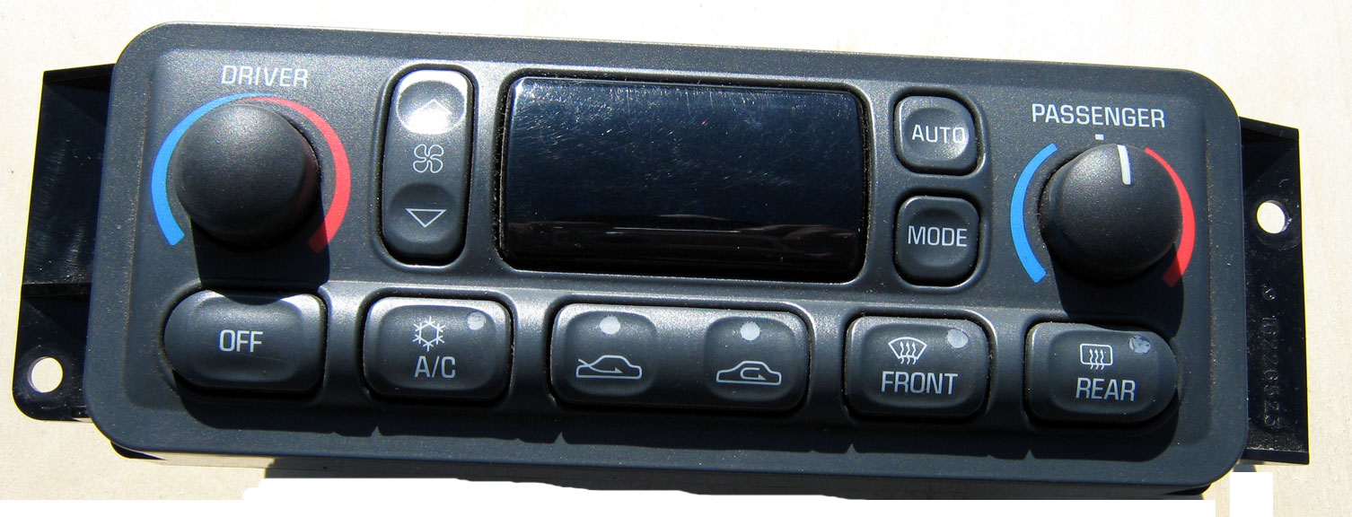

In most cases when the HVAC screen is dim or goes blank there is 5 surface mount resisters that need to be re-soldered shown below.
All 8 screws to take head unit apart need a 3/16 hex head socket.
