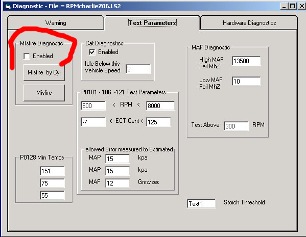

2. Misfire turned off.

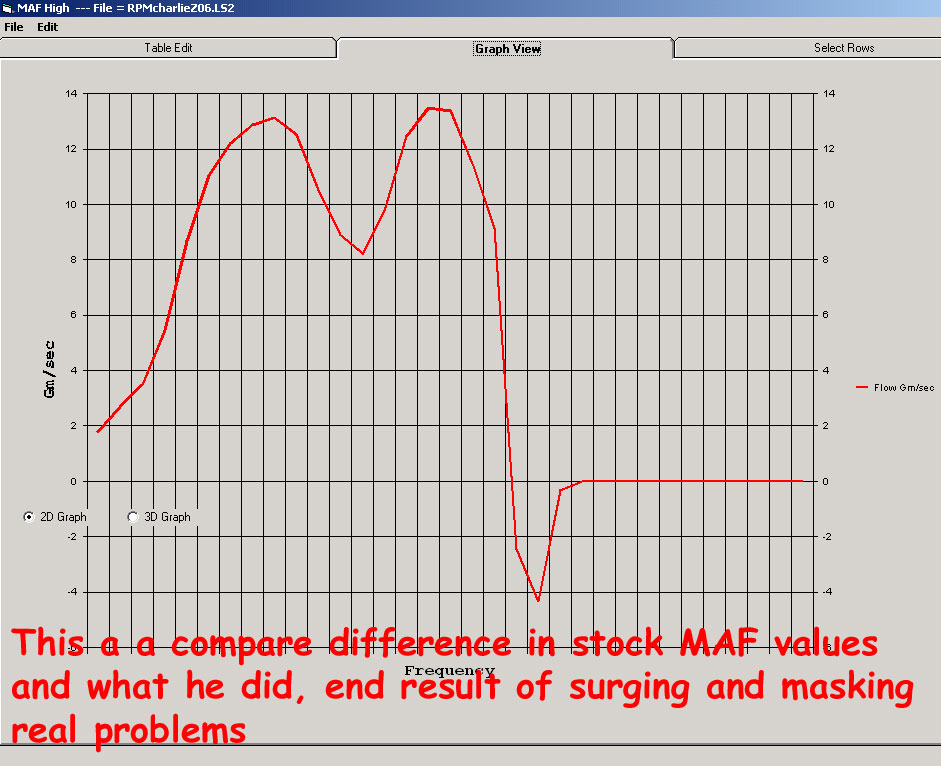

3. MAF table values screwed up.

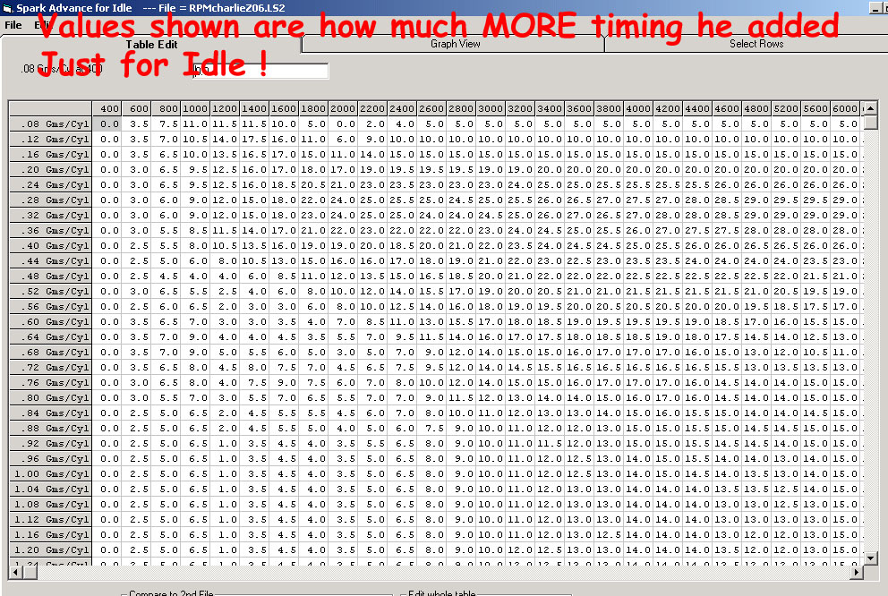

4. Weird timing table values for both high and low octane

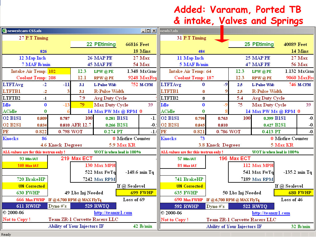

5. So called ported the stock throttlebody, was done badly causing the random idle on decel and bad startups
6. with the costs of new LS7, porting, valve springs, Vararam the end results was ZERO gain and the tune was lousy.

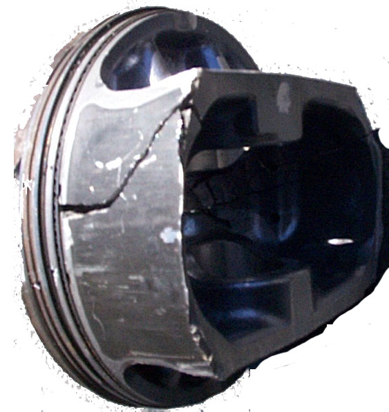

Reason engine was replaced is a radical CAM installed caused valves to smash into the cylinders

Compare via a testrun with scanner shows zero and maybe even a bit less before RPM/Charlie work, mods and his tune.
