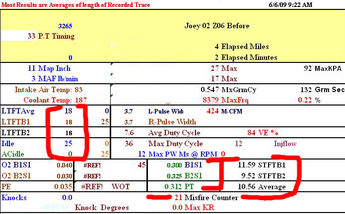

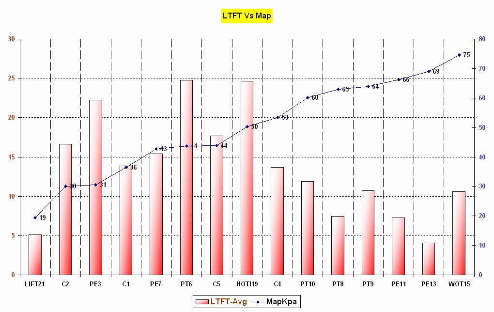

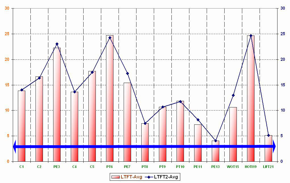

We found in testing and OBD scanner data collection that the fuel trims at idle pegged at 25% too lean for both heads, and engine wanting to die on decel and coming to a stop.

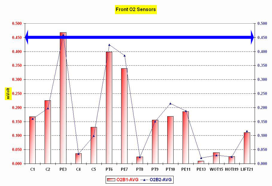

Front 02 sensors reporting way lean, far less then the normal EPA 14.7 AFR ( .450 mVolts.
In asking the new owner and teammate Dennis to trace out the EPA smog AIR system they found the smog pump missing, the vacuum hose to control it uncapped and worse is someone to fool smog stations they installed the AIR hoses to both exhaust manifolds but the 2 ends of those hoses were not connected to each other at all and one of the AIR check valves missing.
This meant air was always being pulled into the exhaust manifolds causing the O2 sensors to see maximum lean conditions which then the PCM would be commanding excess fuel injector ON times.
