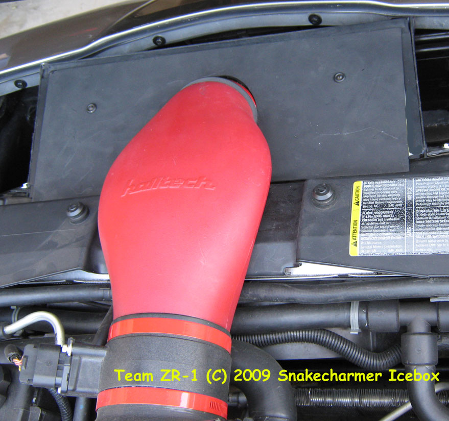

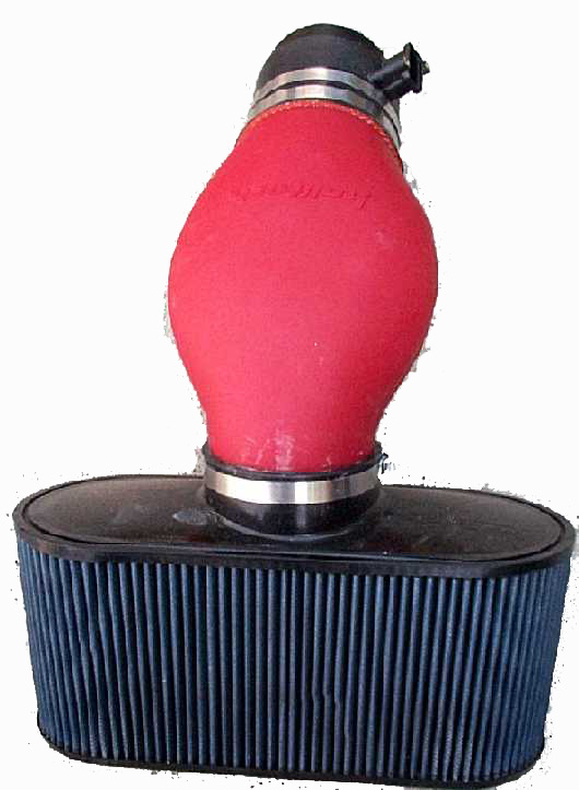

CAI shown at top is that Halltech Snakecharmer.
Not designed well and the co called CAI did little.

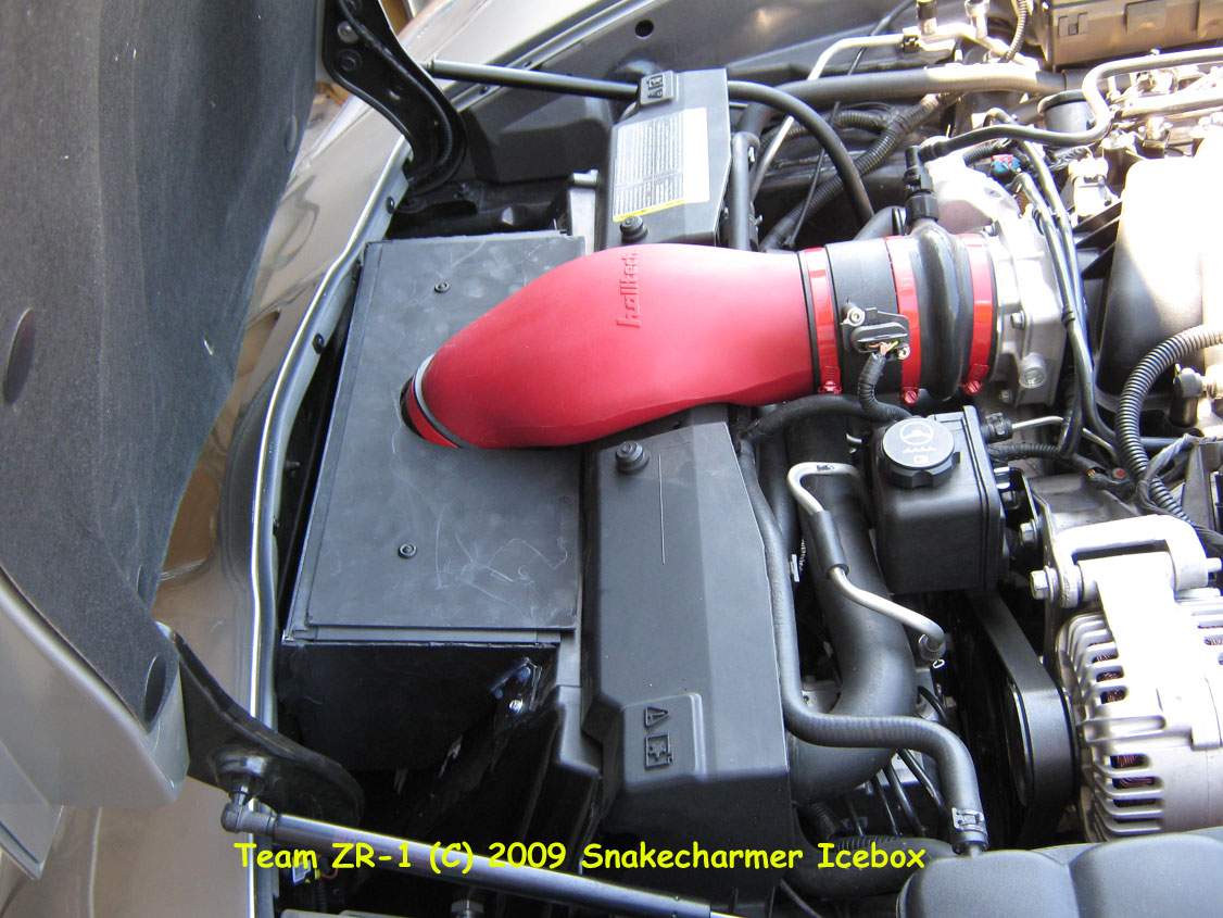

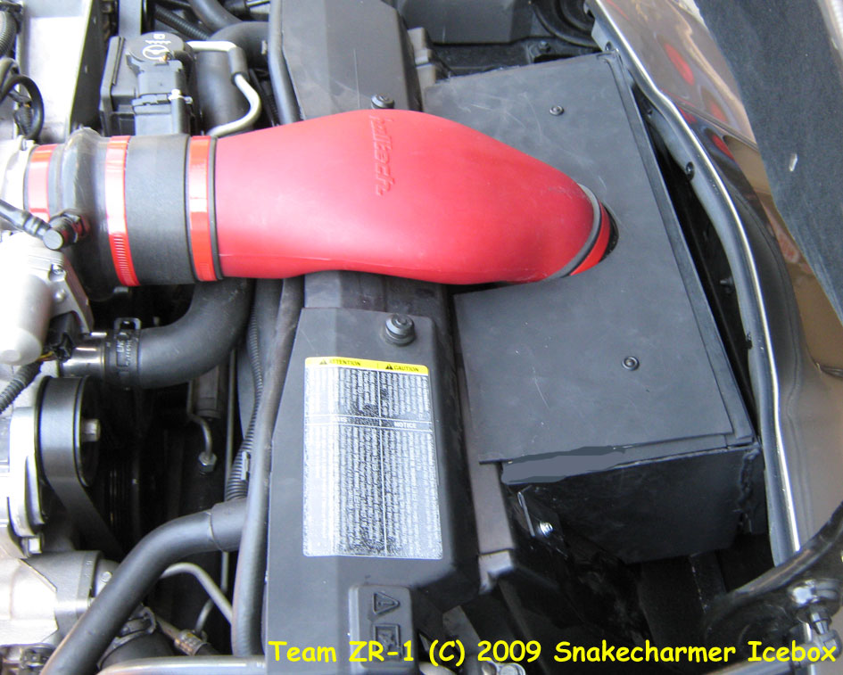

Here we made a Icebox that would fit the shape of the aircleaner and that over sized plastic POS airbridge of theirs.
This assured the hot engine bay air is not getting sucked into the intake manifold
