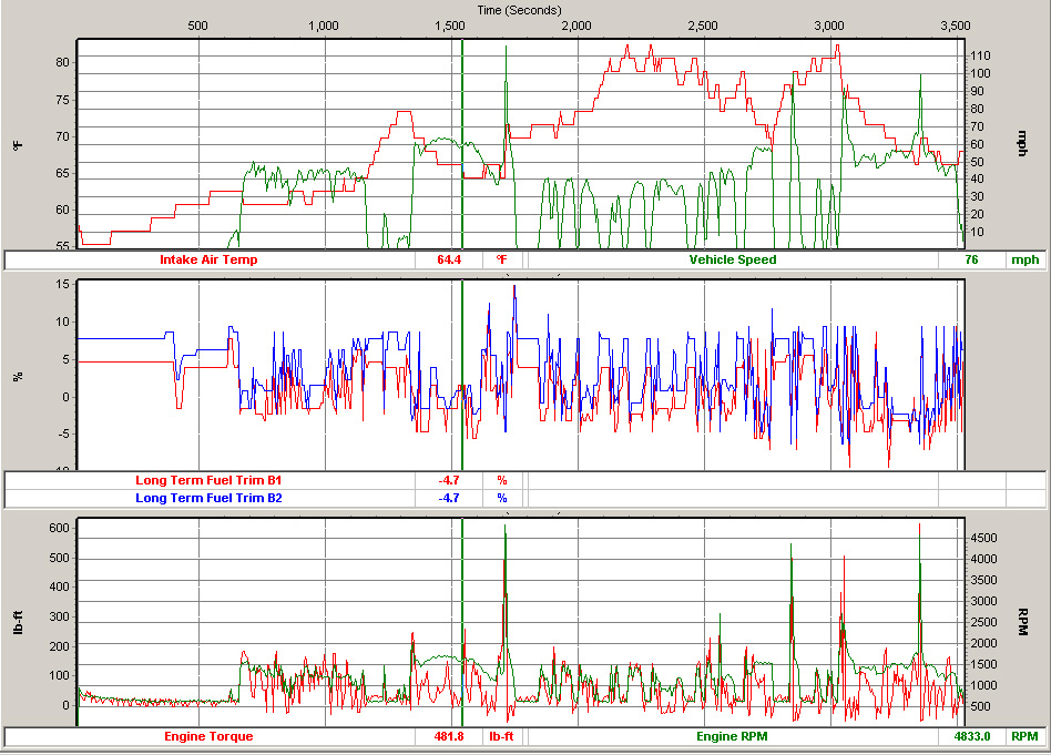

Ist image shows the fuel trims of left and right heads.
We see they are balanced from one another and trims fairly adjusted.

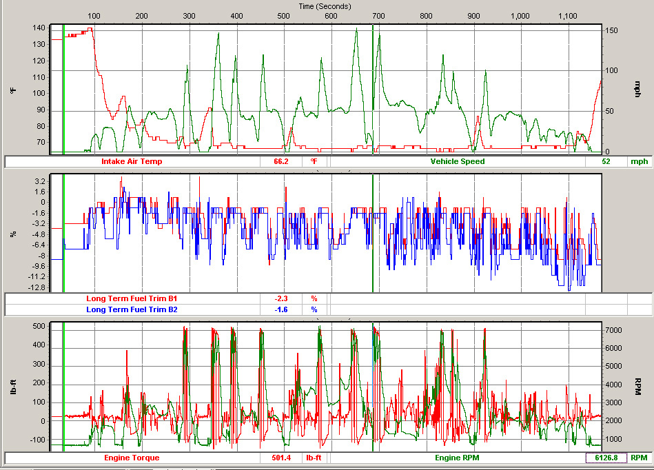

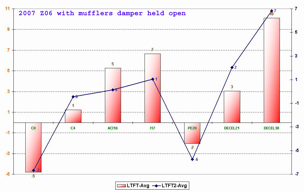

2nd image is with the muffler dampers held open and you see right off an imbalance left/right and at one engine load being lean and just above or below that engine load going rich at lower engine loads.
This says with stock exhaust manifold design GM knows what they are doing and best is to leave dampers functional

#1748 - 06/30/07 11:44 AM Re: C6 Z06 Muffler Damper [Re: teamzr1]
Here is a compare of 2 C6 Z06s, one stock that PCM auto opens and closes the damper in mufflers and another with the fuse for damper pulled
As seen the lower graph of the Z06 with fuse pulled is the fuel trims ( LTFTS) greatly imbalanced to each other.
This is due to no backpressure and not allowing both heads to move the exhaust at the same volume
