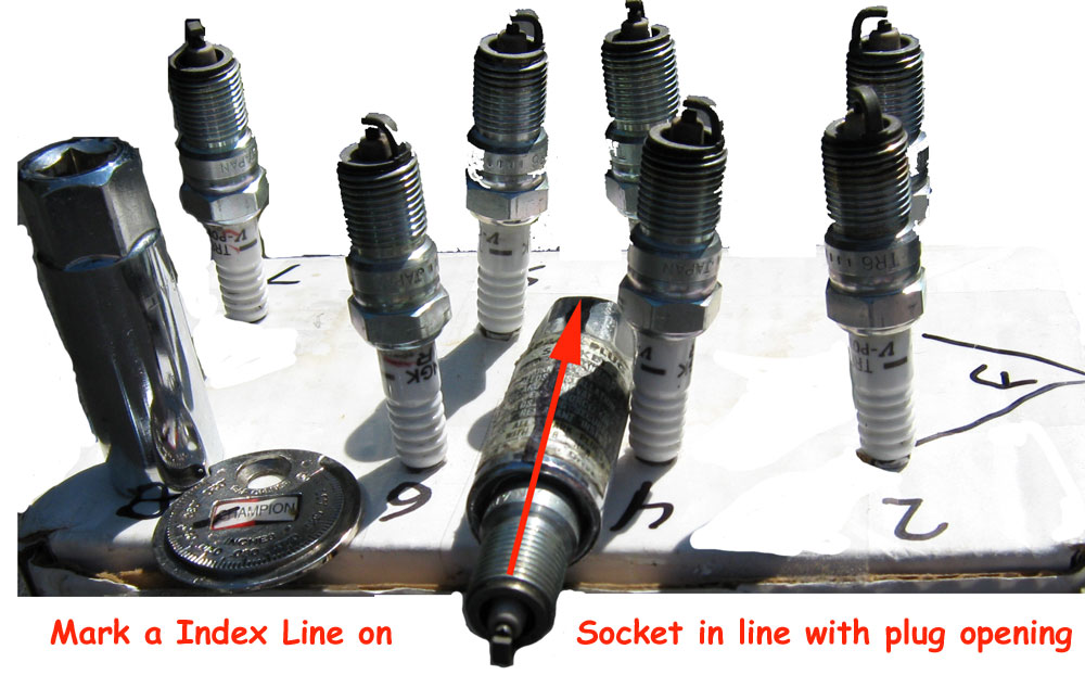

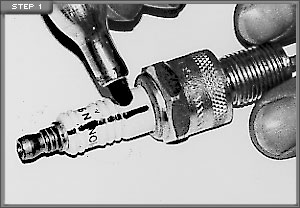

Simple: Mark the spark plug insulator body with a felt marker (never use a pencil, which acts the same as a carbon track inside your distributor cap) on the side where the ground electrode attaches to the spark plug body.

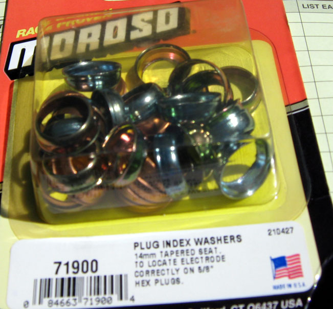

Instead of rummaging through boxes of spark plugs to find the elusive combination of perfect plug threads that match the cylinder head threads, use indexing washers.
These soft copper washers are available from the aftermarket and will fit both flat- and tapered- seat spark plugs.
They're available in three thicknesses: 0.060-inch, 0.080-inch and 0.100-inch.
Copper's inherent softness along with the various washer thicknesses make it simple to thread the spark plug into the cylinder head and tighten it to the point that the index mark is situated in the correct position relative to the combustion chamber.
(Never double up washers; they aren't intended to be used in tandem.)

You need to purchase indexing washers such as the ones I did seen below for C5/C6s
