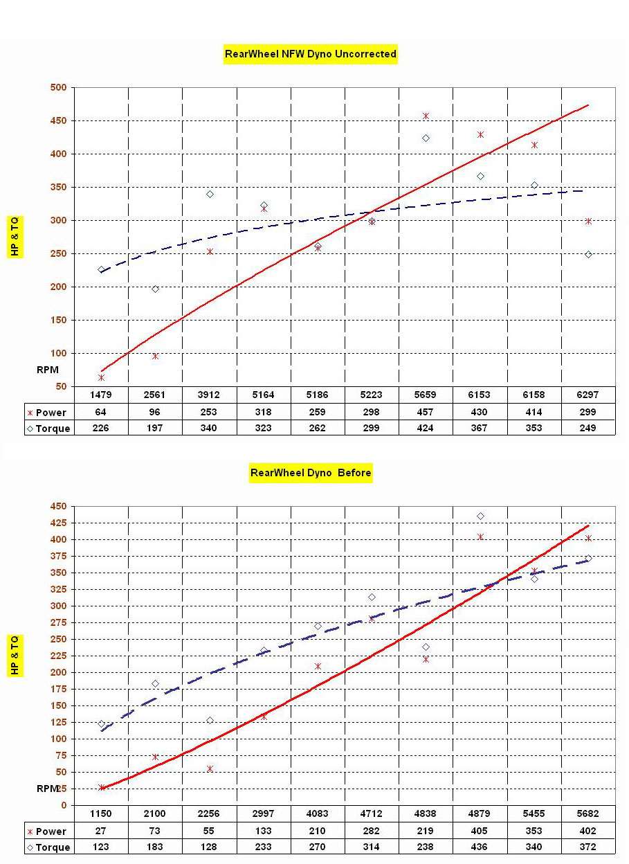

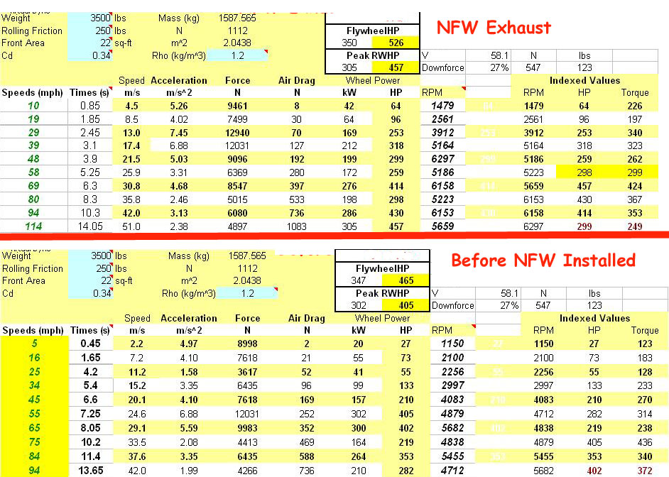

Here is results of before the NFW exhaust was installed and then with it on. This is with the full length design with the tailpipes.
Weather was 85 degrees adding 1,500 feet to the 4,000 feet elevation tests were done at Notice the lower torque comes up sooner and faster now with the end to end system being 3 inch
