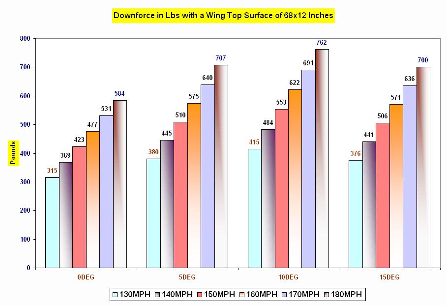

#2748 - 08/17/08 03:25 PM Re: Downforce Rearend [Re: teamzr1]
Calculating downforce with a wing upper surface of 68 inches by 12 inches.
From speeds of 130 to 180 MPH wth wing angles of 0, 5, 10 and 15 degrees
Results are in pounds of downforce
