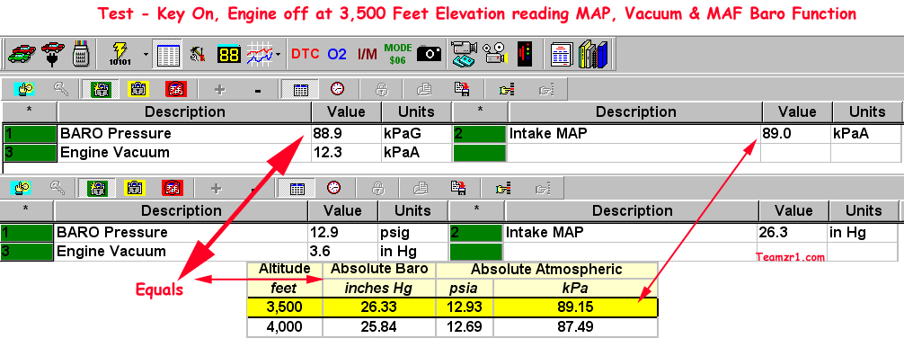

Now to put this to a test to verify the MAF and MAP sensors I did this test with Key On, Engine off using our OBD scanner at 3,500 feet elevation and as you see both sensor's values equals the math.
This assures both sensors working correctly
