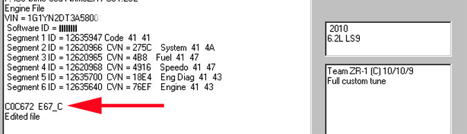

If tuning a 2010 ZR1 GM used a new PCM version that is not the same as used for 2009 ZR1 LS9

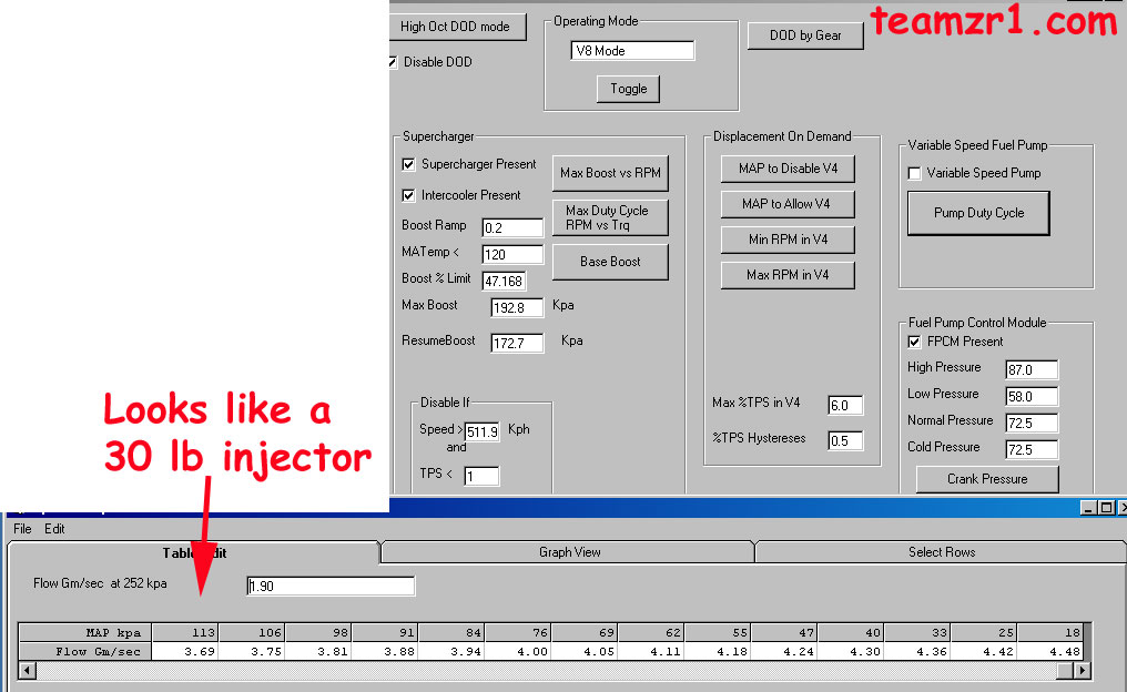

Lots of neat tunable areas for the 3 stage fuel system and supercharger.

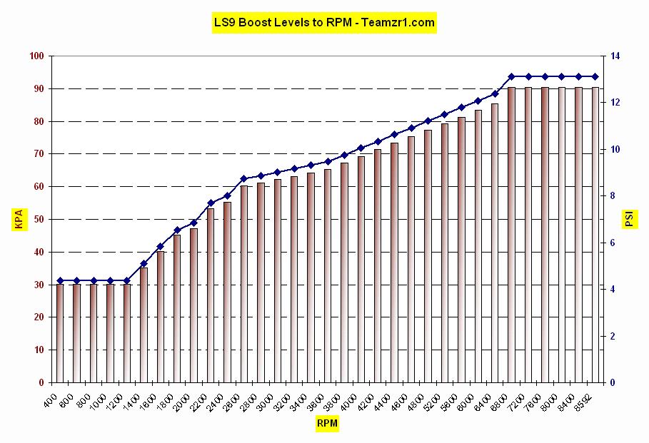

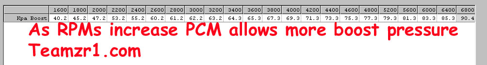

As engine RPMs increase the PCM allows more boost pressure.
Stock is 13 PSI of boost maximum
Doing the math in Kpa and PSI maps out to engine RPMs as below
