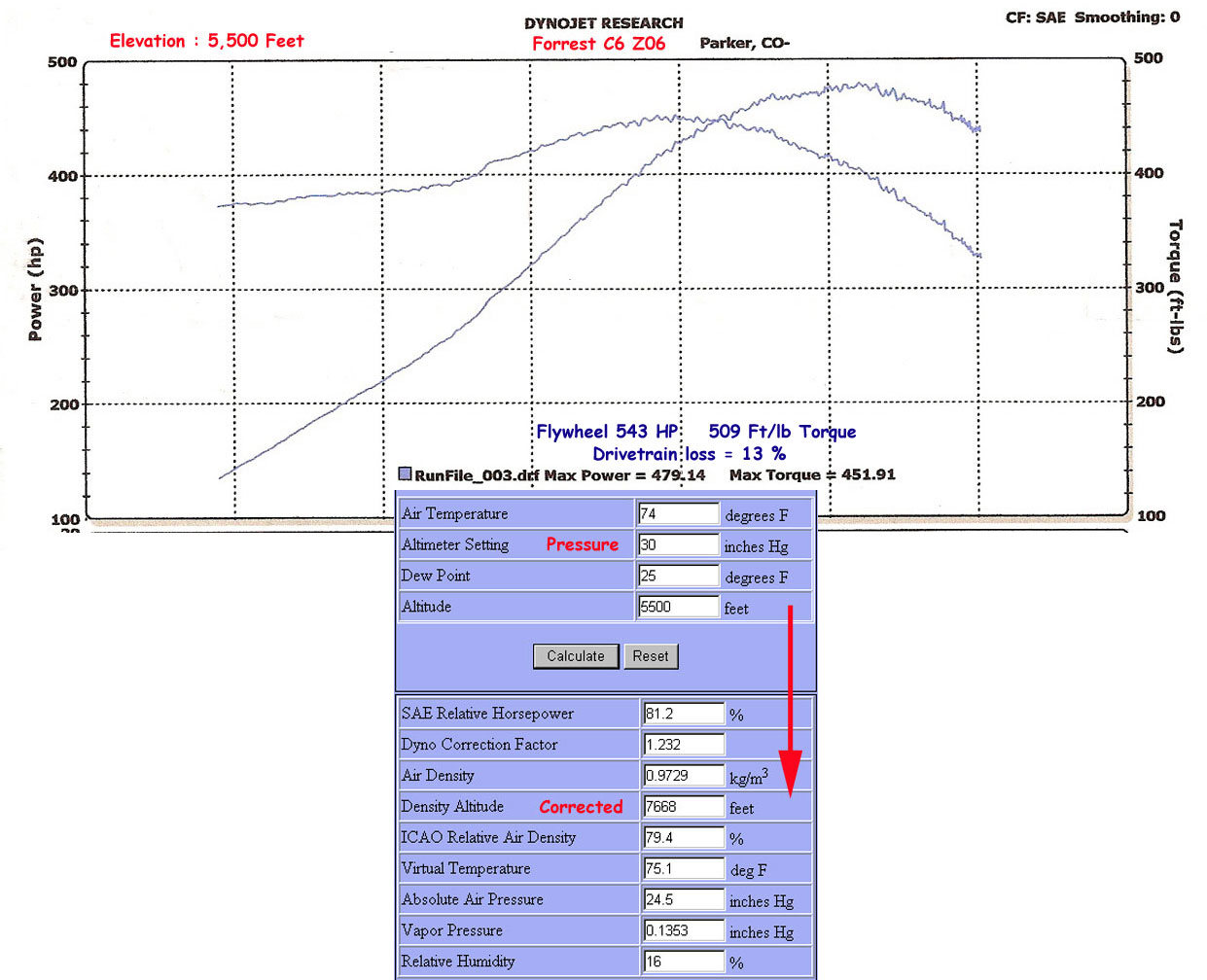

#3170 - 10/18/0906:03 PMStock C6 Z06 with just a tune
Posts: 6,044
This C6 Z06 totally stock except for a tune on a static dyno drum. Elevation was at 5,500 Feet. I suspect the D/A is calculated a bit too low as the math shown below to include weather and 5,500 ft elevation
