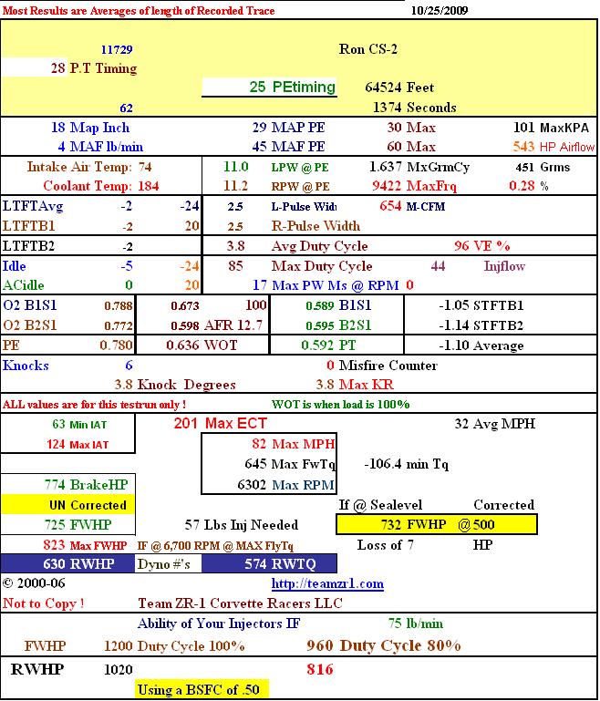

Race CAM in a 2007 C6 Z06 Corvette
Posts: 5,976
Posts: 5,976
Results of us custom tuning a 2007 Z07 with a race CAM, ported intake and throttlebody, 70 lb injectors, and headers
Tough to tune for street as where at idle MAP would be around 35 KPA this LS7 now is at 80 KPA which means very little vacuum.
