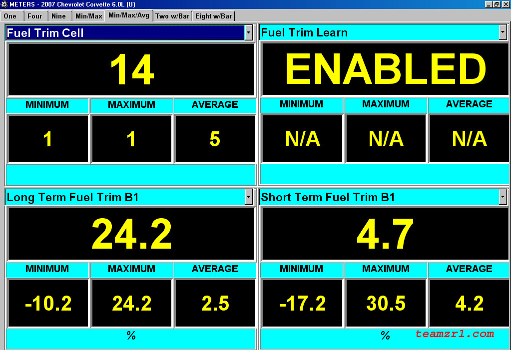

This scanner screen capture is using the meters mode of our scanner
Notice the averages look perfect so you assume all is OK but look further and see what the maximum values were for long and short term fuel trims

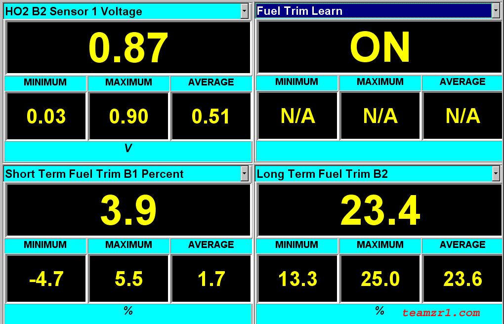

Notice how lean the LTFT is and fuel trim learn is enabled and that the minimum for that drive cycle for both long and short terms at time are super rich

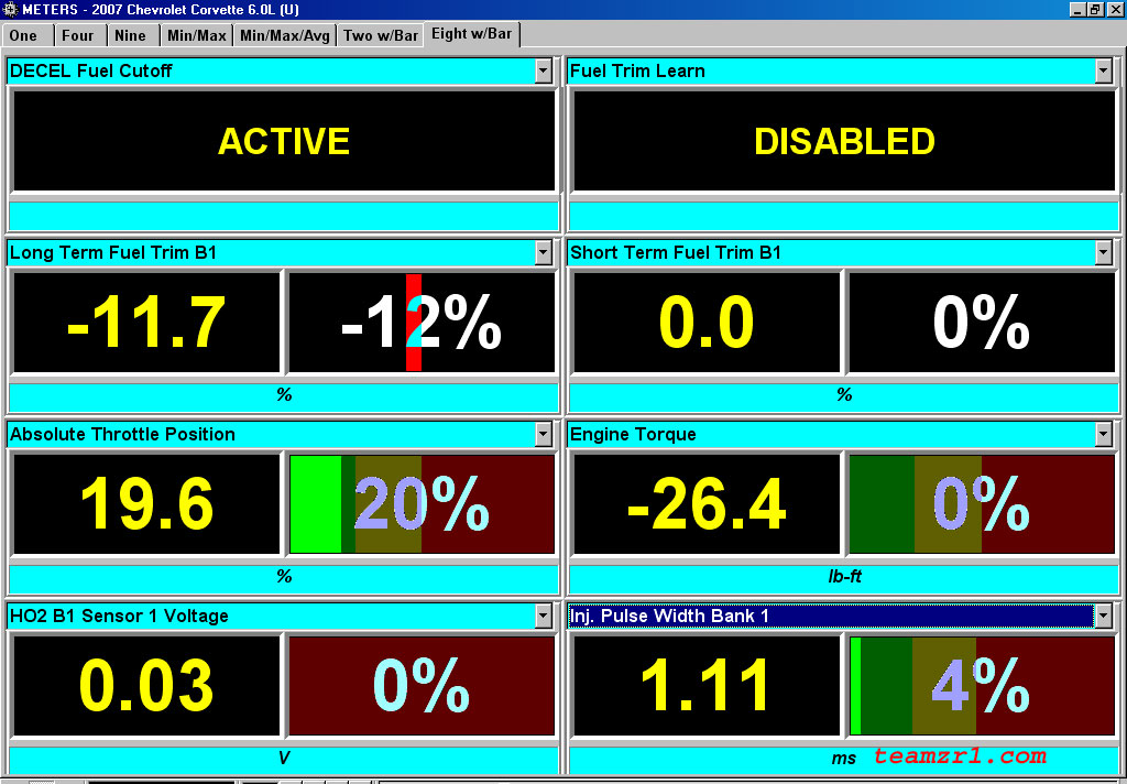

Here using 8 meters we see when engine is in decel and fuel learn is disabled as throttle is closed as lifting the gas pedal. The negative torque value assures engine was commanded for decel
Long term is reporting rich yet short term shows otherwise

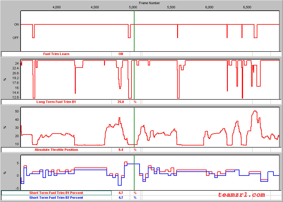

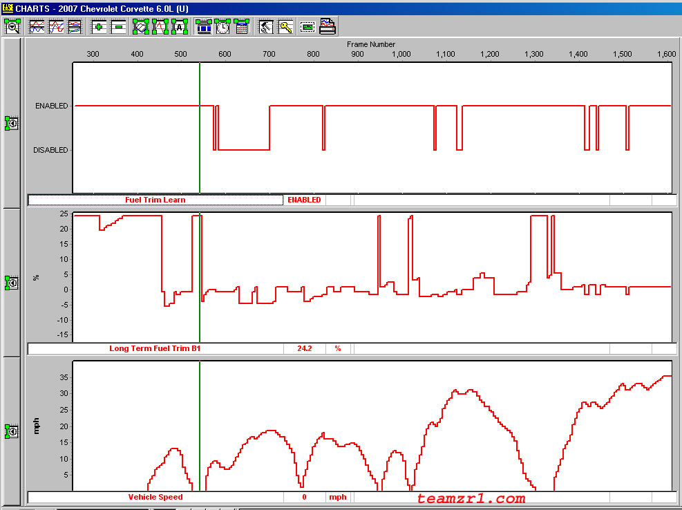

If you look at the scanner data in charts mode you realize that perfect fuel trims average overall did not tell the whole story as you see here any time engine is at idle the LTFT only report way too lean and fuel learn is enabled

This then clearly shows there is some type of unmetered air flow problem such as a leak between the aircleaner and throttlebody.
This shows you must spend the effort to analyze the scanner data you bothered to do a recorded scanner testrun
Notice how LTFTs show super lean yet STFTs report normal ?

This shows a different problem.
Notice the LTFTs are mostly way too lean in almost all engine conditions.
This would be like bad E10 gas, exhaust leak or bad O2 sensors
