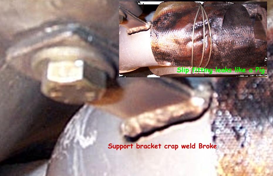

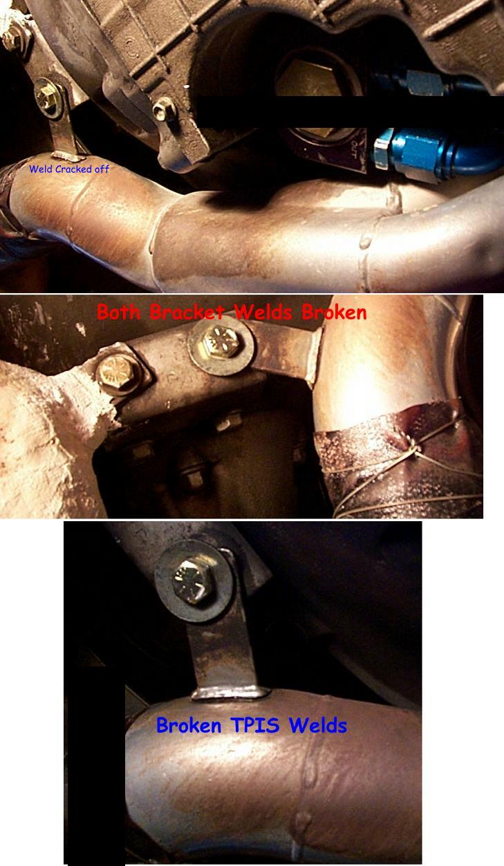

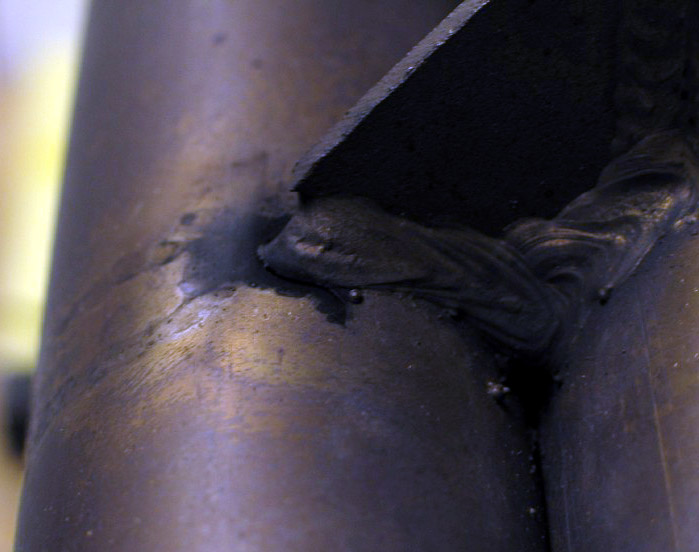

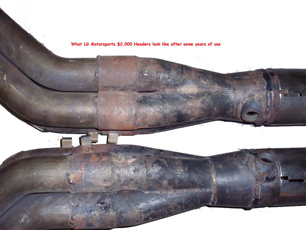

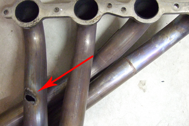

Just because you spent a lot of money for performance headers does not mean your getting even a low grade product
Assure before paying that good grade of stainless steel or mild steel is used, proper welding is done and if stainless steel not to use a heat coating as this can cause welds to crack as heat is trapped and the pipe expanding where weld does not
