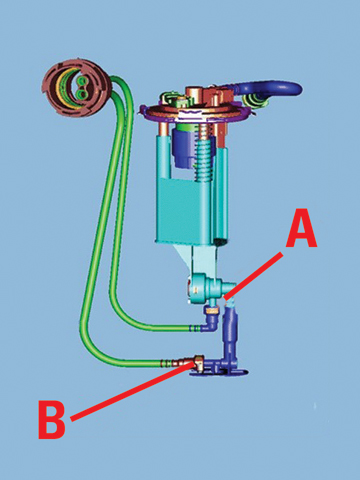

This may be due to the right hand fuel tank internal supply and return line connections which may be loose. This condition allows fuel to be transferred to the right hand fuel tank but not fed back to the left hand fuel tank. DTCs P2066 and/or P2636 may set.

3. If the voltage for the right fuel sensor reads 2.46 volts or less, there is reason to believe one of the fuel line connections is loose. Remove the right fuel tank sending unit and inspect the supply line and return line
4. Secure the supply and/or return line(s) at the bottom of the fuel sender.
