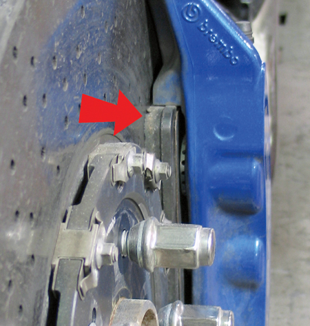

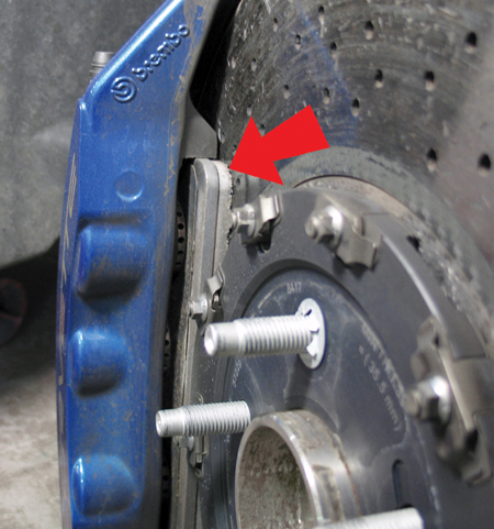

A White appearance results from light street burnishing (fig. 17)
B White appearance results from heavier track burnishing (fig.18)

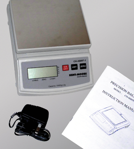

Special tool CH-48897 is a scale that accurately measures the mass of the brake rotor to determine its suitability for re-use. Before each measurement cycle, use the supplied calibrated weight to calibrate the scale.
