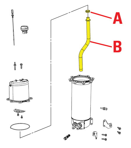

This noise may be caused by the internal transfer tube in the engine oil tank hitting the inside of the tank cover. The seal (O-ring) that secures the tube in place may split and slide down the tube, allowing the tube to be loose.
A Seal (O-ring)
B Tube
