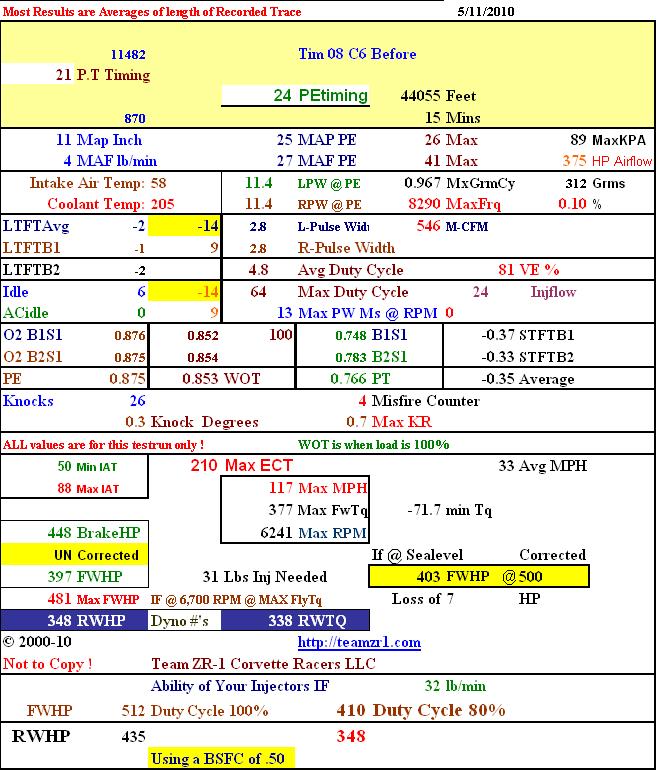

Here is a BEFORE testrun results.
Run was 44,000 feet duration of 15 minutes
Has a crappy Breathless tune.
As seen even with E10 gas which would lean up AFR about 8% it still is running up to 14% too rich.
Also seen is misfires and max flywheel torque at about 375 ft/lbs at 400 HP.
Has a Breathless CAI, weather was 50 degrees, airbridge to intake ran a average of 58 deg to a maximum of 88 deg.
Maximum WOT timing of 24 degrees.
Maximum airflow was 41 lbs.

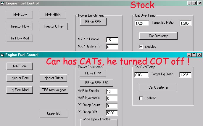

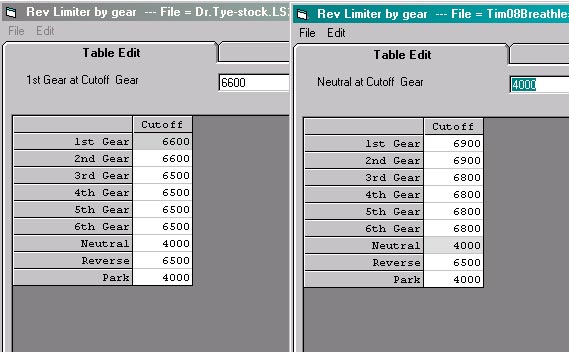

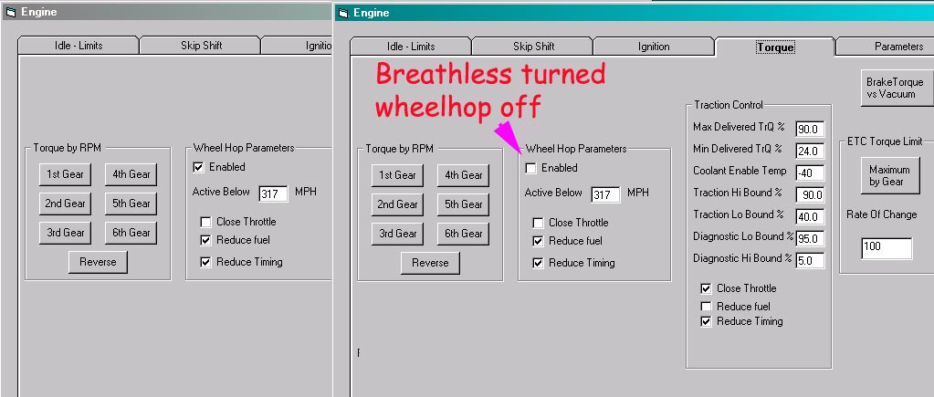

Comparing stock tune to the Breathless we find tune was junk
Just part of what was seen,
WOT set way too rich
Torque management turned off, being a A6 will have too much stress
Rev limiter set as high as 6,900 RPM for lower gears with stock engine.
Wheelhop turned off
Cat over temp protection turned off even though the CATs are installed. sex

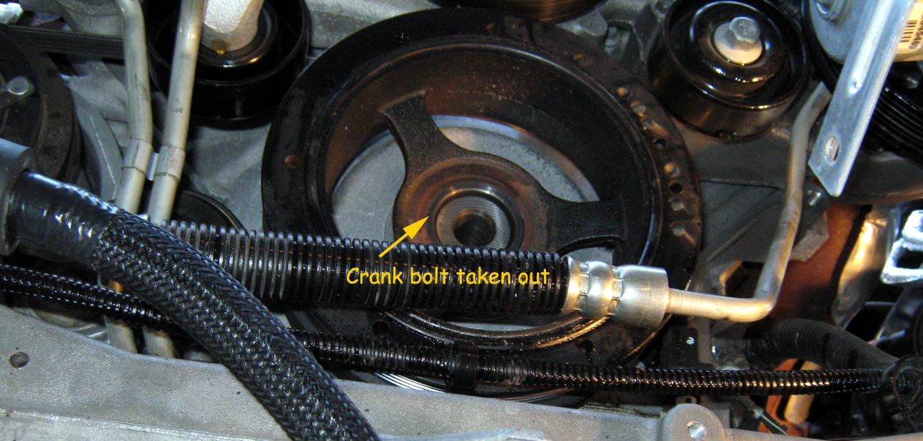

For day 3, using a 450 ft/lb torque impact wrench with a 120 PSI air compressor still would not break the crank bolt loose.
Then got a very large breaker bar and using a 5 foot steel pipe on the bar finally broke bolt loose.

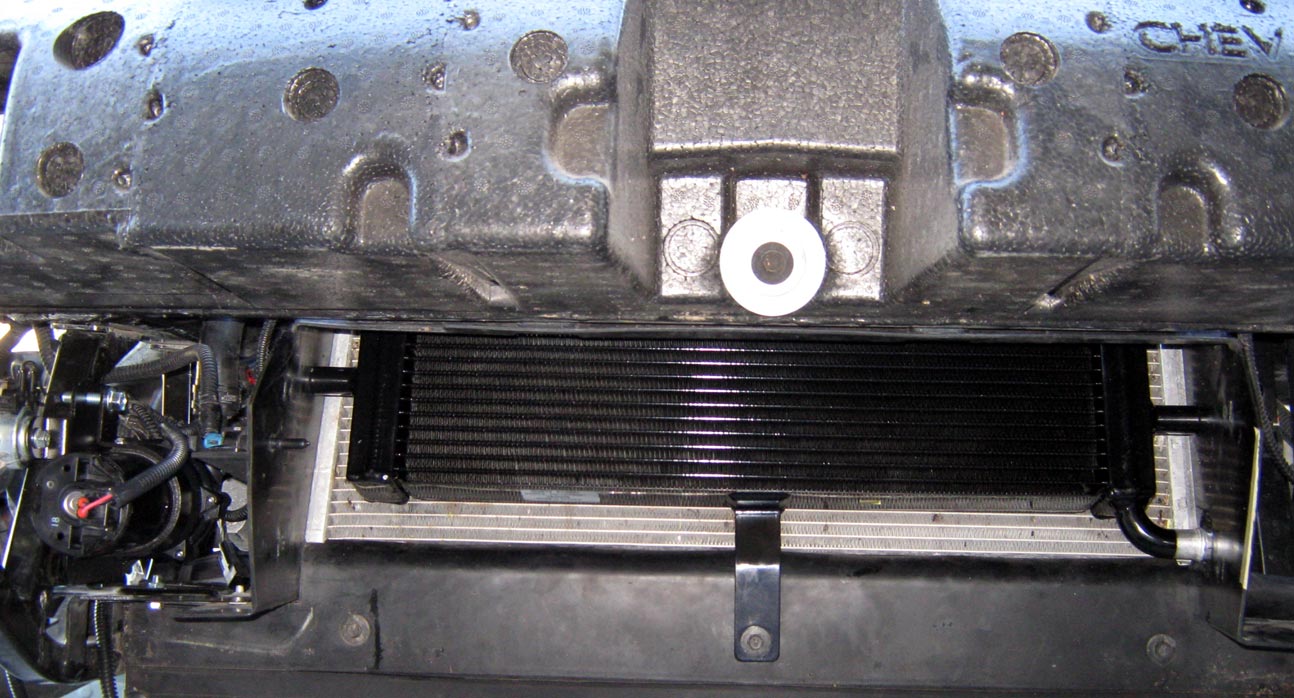

Not happy that the heat exchanger for this supercharger sits in front of A/C and radiator to limit air flow

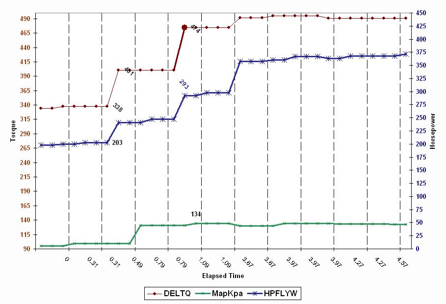

This scanner recorded data of this C6 shows the reaction time of going from NA to boost coming on
At the bottom of graph you see elapsed time and graph showing torque, horsepower and MAP.
At this elevation of 3,500 feet the maximum MAP can be is 90 KPA ( where sealevel would be 104 KPA) and you can tell then by MAP data when boost came on and this case up to 135 KPA which is -10 inches of vacuum.
Notice that the time boost came on that within 1/2 second torque went from 338 ft/lbs to 474 ft/lbs.

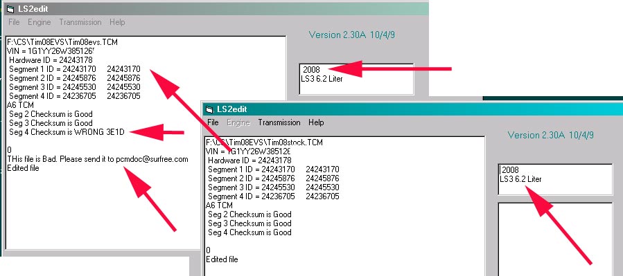

Owner contacted me to say the vendor super screwed up and the SCTuner black box they programmed it to flash the A6's TCM with a 4 speed trannie flash !
There is not even a C5 with a A4 that would have had a internal TCM nor any 2008 having a 4 speed.
Owner says it took them 15 TCM flashes to get it right and at this point the dealer had to tear the A6 apart and change parts due to the wrong TCM flash being used.
Even then I do not buy the vendors answer as seen below when the TCM flash before using the SCTuner and then after the tuning tool sees both as a 2008 C6, the code segments are then same and even sees in both as a A6
This says the vendors involved never did the QA testing to assure when their tuner box flashed that valid software was being forced into the TCM and worst is no tuner tool could fix the problem since the tools saw the TCM flash as invalid

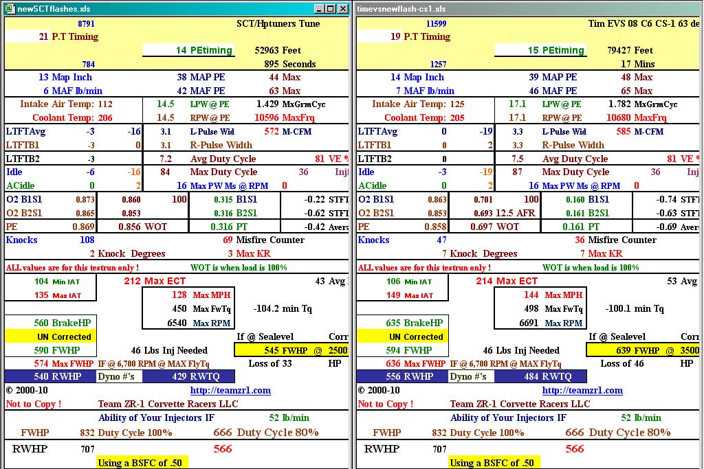

Met owner today and I spent 3 hours cleaning up their tunes which are not very good.
As you see in results the gains when we properly custom tune PCM and TCM
Results on left side is testrun with their tunes installed
On right side is with testrun with our custom tune installed
increased torque by 50 ft/lbs and HP up about 90 at flywheel thus the finding is if installing this EVS kit do NOT use their canned tuner for any reason.
