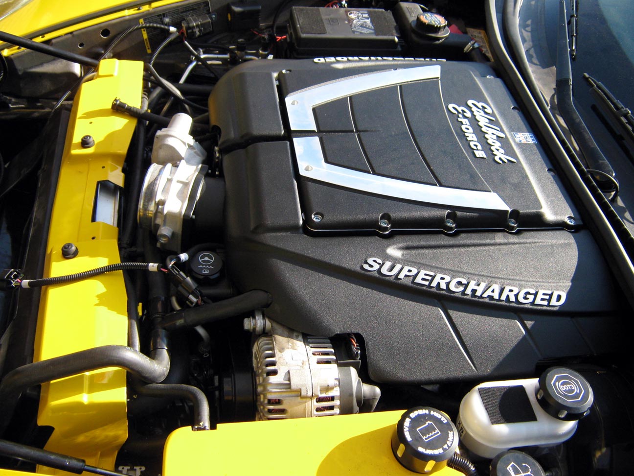

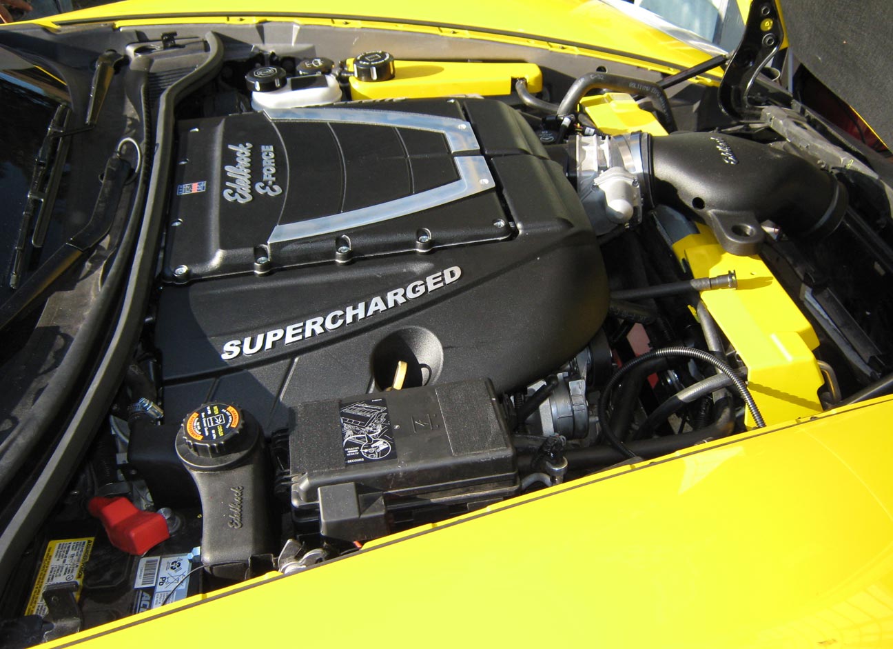

In process of installed the EVS 1590 supercharger on a 2008 LS3 with A6 Corvette
Come back for updates as the install is completed, custom tune, testruns and results. Have about 8 hours labor at this time.
Suspect total will be about 24 hours of labor
Click on any picture and then use the autoplay icon for slideshow or arrows to move through images, commands on top
Install EVS

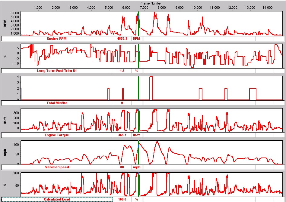

Here is a BEFORE testrun results.
Run was 44,000 feet duration of 15 minutes
Has a crappy Breathless tune.
As seen even with E10 gas which would lean up AFR about 8% it still is running up to 14% too rich.
Also seen is misfires and max flywheel torque at about 375 ft/lbs at 400 HP.
Has a Breathless CAI, weather was 50 degrees, airbridge to intake ran a average of 58 deg to a maximum of 88 deg.
Maximum WOT timing of 24 degrees.
Maximum airflow was 41 lbs.

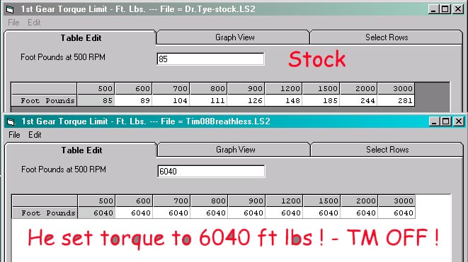

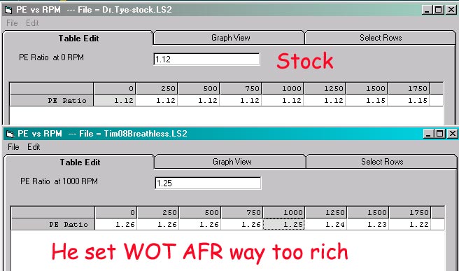

Comparing stock tune to the Breathless we find tune was junk
Just part of what was seen,
WOT set way too rich
Torque management turned off, being a A6 will have too much stress
Rev limiter set as high as 6,900 RPM for lower gears with stock engine.
Wheelhop turned off
Cat over temp protection turned off even though the CATs are installed. sex

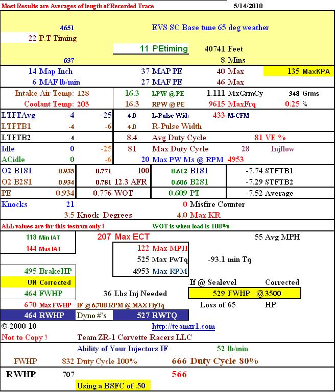

Here is testrun results, but again this is not maximum numbers and will have to be retested when the A6 issues are resolved
At the least there is a flywheel gain of 125 in HP and 150 ft/lbs Tq
