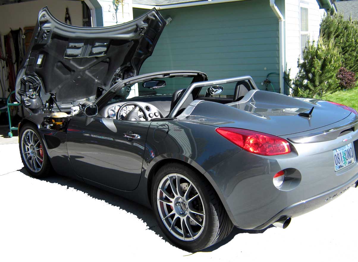

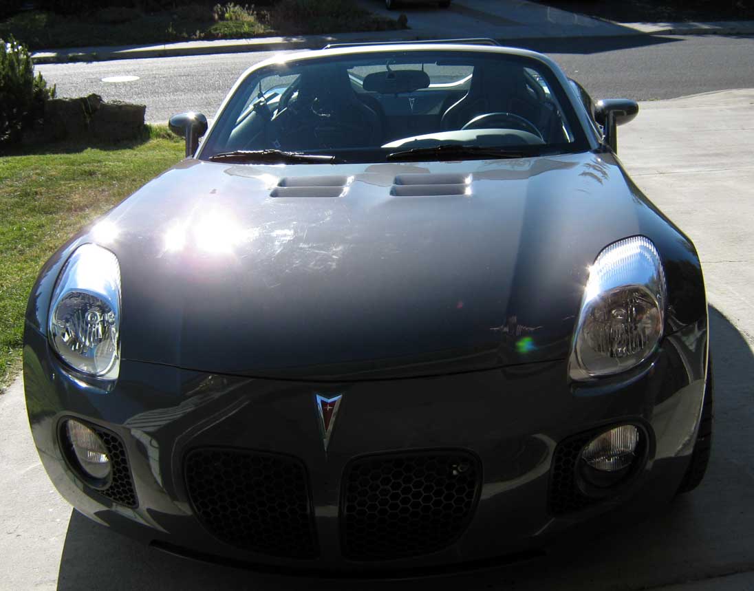

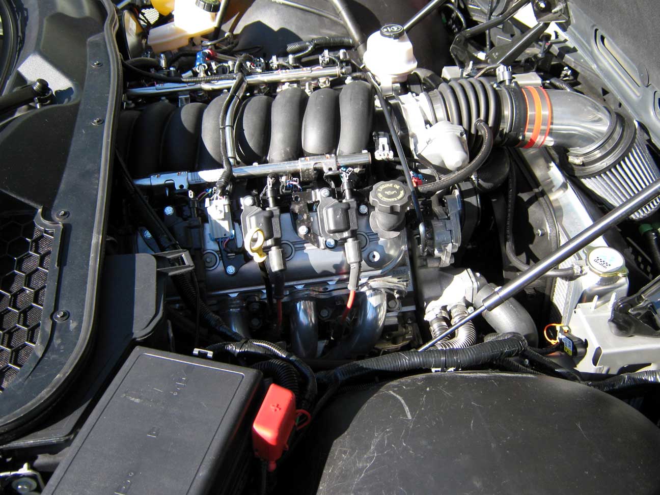

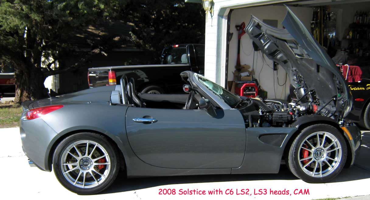

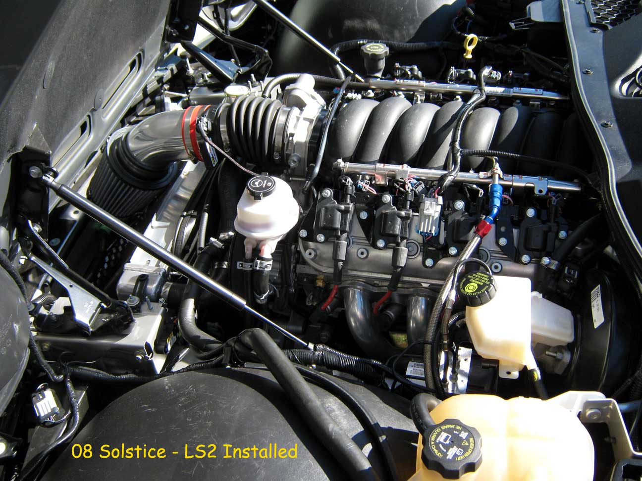

This project was shoehorning a LS2 with a T56 manual trannie into a 2008 Solstice.
LS2 with drive by wire like a C6 Corvette but the car is for racetrack use mostly so many of the functions of a car are gone.
This required the PCM flashed as a 2007 C6 and configured as a standalone as trannie is not what comes with a C6.
Has LS3 heads, CAM, also headers, 3rd party radiator fans not controlled by the PCM.
Functions like A/C and even cruise control no longer exist so tuning and making this run is a challenge
At this point car is mobile but clean up and final tune will be done next week and updates will be posted.

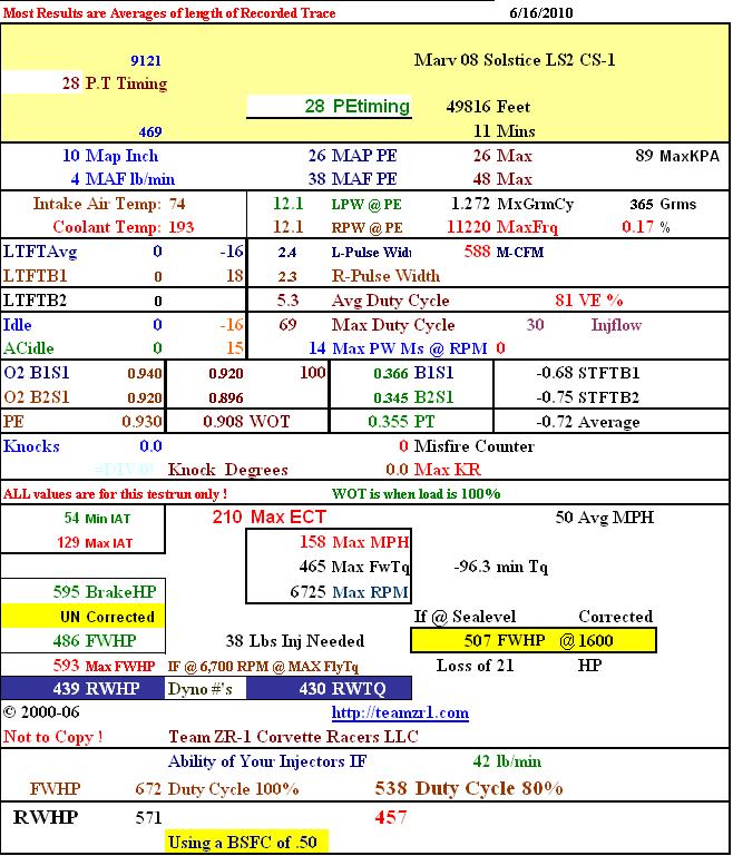

Here is the results after the final tune
Quite a bit of difference when the car originally had a 4 liter engine with a turbo with less then 300 HP
Being a small car weighing 3,000 pounds will be a threat to stock C6 Z06
