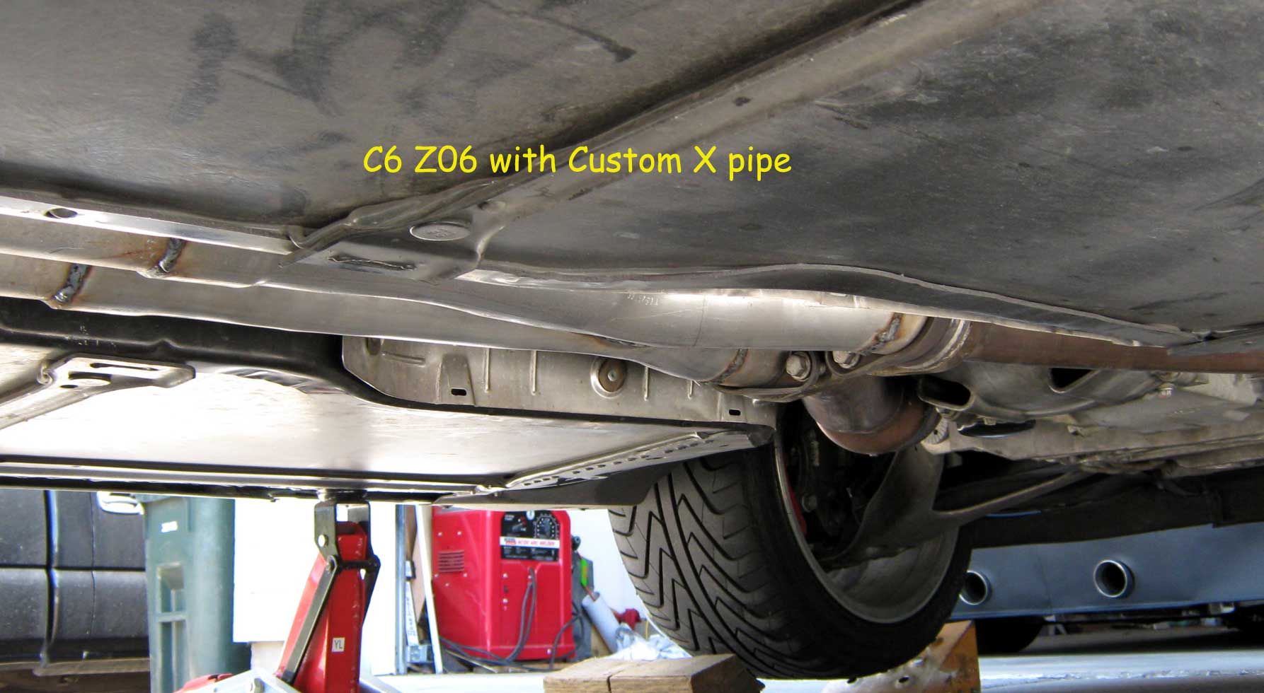

C6 Z06 Corvette has stock exhaust, no headers but with a custom 3 inch X-pipe

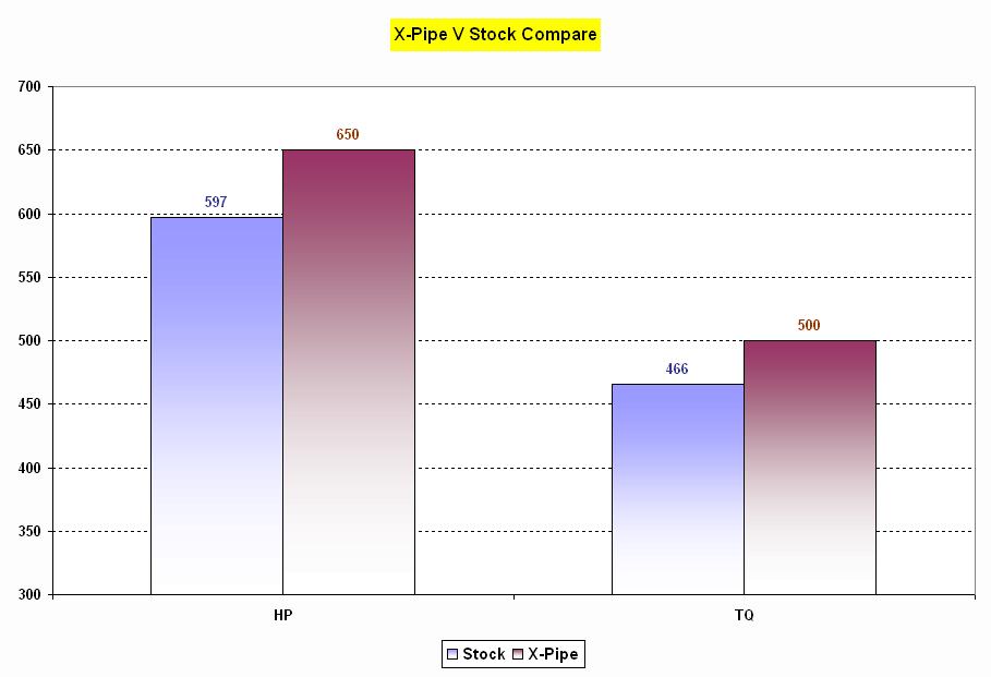

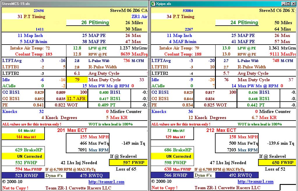

Sound level in Dba went down from 94 to 85 Dba at idle with X-pipe installed. Good exhaust pulses can now be heard
As we have seen in other Corvettes ( review other Xpipe test results in other threads) gains with a proper size and placement see about 50 HP and Tq
Review test results below

Testrun of this 2006 Z06 with custom exhaust X-pipe.
Weather 82 degrees, elevation 3600 feet.
