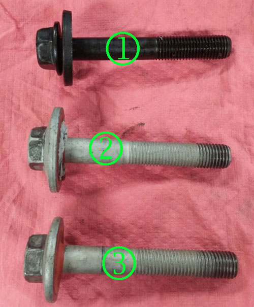

Gen 5 and Gen 4 Bolt Identification
The bolts shown below are:
Bolt 1– Gen 5 engine Bolt 2 – Gen 5 engine Bolt 3 – Gen 4 engine

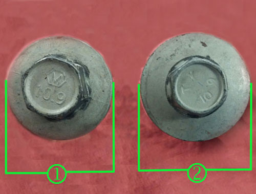

Bolt measurements are:
Bolt 1 – 1 piece Gen 4 bolt: 1.869 in. (47.5 mm) at the flange Bolt 2 – 1 piece Gen 5 Bolt: 2.055 in. (52.2 mm) at the flange
TIP: The LT1 engine dry sump uses a longer bolt due to the oil pump that is used on this system
