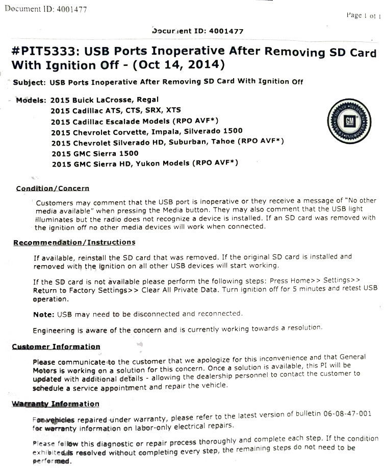

USB Issue for 2015 Stingray
Posts: 5,861
Posts: 5,861
Refer to this TSB
