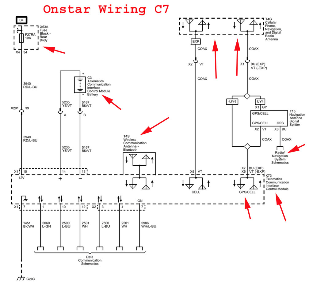

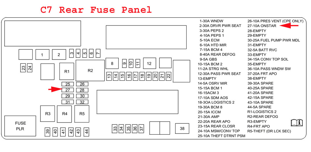

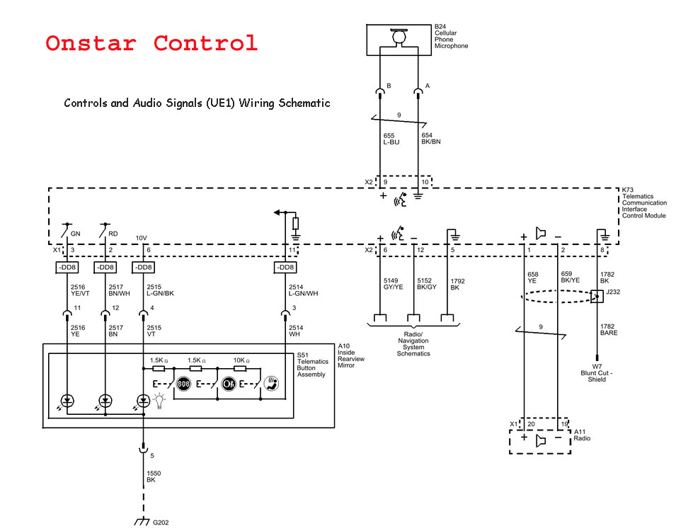

C7 Corvette Onstar wiring and Control
Posts: 5,858
Posts: 5,858
If your looking to yank Onstar
