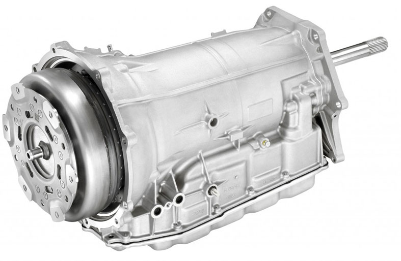

During the development of the all-new, GM-developed Hydra-Matic 8L90 8-speed automatic transmission (RPO M5U) (Fig 1), offered on the 2015 Corvette, Silverado, Sierra, Yukon, Yukon XL, and Escalade, more than 550 computer-aided engineering analysis were made to ensure strength, durability, performance and refinement.
In the Corvette Stingray, the results are a paddle-shift that delivers world-class shift times rivaling the best dual-clutch designs.
While in the Silverado and Sierra, the new transmission delivers 11 percent greater torque capacity than the 6L80 6-speed transmission it replaces.

The eight speed ratios of the 8-speed transmission are generated using four simple planetary gear sets, two brake clutches, and three rotating clutches. (Fig. 2)
The resultant on-axis transmission architecture utilizes a “squashed” torque converter, an off-axis pump and four close coupled gear sets.

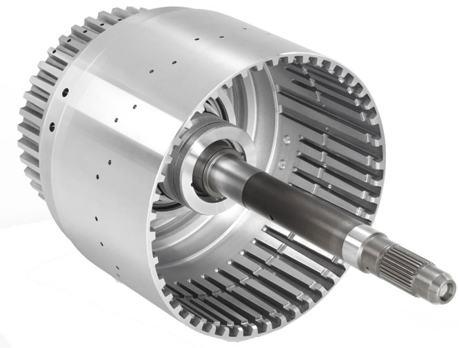

The three rotating clutches have been located forward of the gear sets to minimize the length of oil feeds which provides for enhanced shift response.
There are different variants of the transmission, all based on torque capacity. Architecture is common between the variants, and component differences are primarily related to size.
2015 Hydra-Matic 8L90 (M5U) Eight Speed RWD Automatic Transaxle
The Transmission Control Module (TCM) is externally mounted. It makes use of three speed sensors that provide for enhanced shift response and accuracy.

The 4-element torque converter contains a pump, a turbine, a pressure plate splined to the turbine, and a stator assembly.

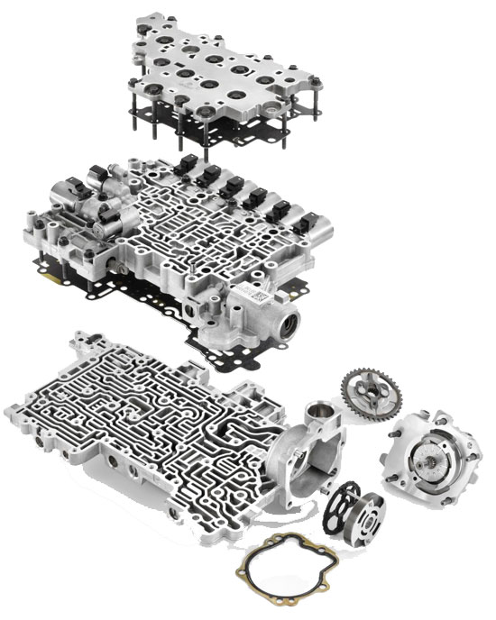

The hydraulic system primarily consists of an off-axis chain-driven binary vane-type pump located in the valve body, and two control valve body assemblies. (Fig. 3)

Clutch compensators are fed by lubrication oil rather than the dedicated and regulated feed design of the 6L80 transmission.
This design reduces the number of rotating oil seals and oil channels within the turbine shaft and adds the capability of rapid discharge of oil in the compensators during clutch apply for greater control.

Transmission Solenoid Valves
The 8L90 transmission contains a total of nine individual solenoids in the lower control valve body assembly. Seven of the nine solenoid valves are used to control pressure regulation and direction of transmission fluid and the two on/off solenoid valves are only used to direct transmission fluid.
There are three variations of pressure regulating solenoid valves used on this transmission: high pressure normally low; high pressure normally high; and low pressure normally high, variable force.
High Pressure indicates the solenoid valve is controlling or directing line pressure.
Low Pressure indicates the solenoid valve is directing a pressurized fluid that is less than line pressure.
Normally Low is when no current is applied to the solenoid valve coil, the variable restriction is closed, resulting in no or low pressure.
Normally High is when no current is applied to the solenoid valve coil, the variable restriction is open, resulting in maximum or high pressure.
The Variable Force Solenoid Valve can increase or decrease the amount of pressurized fluid based on the amount of current applied to solenoid valve coil.
Pressure Regulating Solenoid Valves
Pressure regulating solenoid valves regulate hydraulic fluid pressure based on current flow through the solenoid valve coil windings.
They are operated by a 12V high side driver and a low side driver, both internal to the TCM. Current is controlled by turning the low side on and off.
If the TCM detects a malfunction, it turns off the high side driver to that solenoid and sets a DTC.
Transmission control solenoid valves 2, 3, and 7 are high pressure, normally low, variable force solenoid valves; increased current results in increased fluid pressure.
Transmission control solenoid valves 1, 5, and 6 are low pressure, normally high, variable force solenoid valves; increased current results in a decrease in fluid pressure.
Transmission control solenoid valve 4 is a high pressure, normally high, variable force solenoid valve; increased current results in a decrease in fluid pressure.
Transmission control solenoid valves 8 and 9 are normally low, on/off solenoids. These solenoids only direct hydraulic fluid pressure when commanded on.
