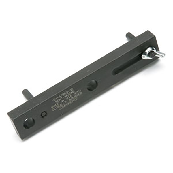

Digital Angle Gauge Adapter
The Digital Angle Gauge Adapter, CH-47960-10, is custom-designed to fit the Corvette knuckle. (Fig. 9)
It is not available in the aftermarket and was shipped to all authorized Corvette dealerships as part of the essential tool package for Corvette for the 2014 model year.
F09 CH 47960-10 adapter

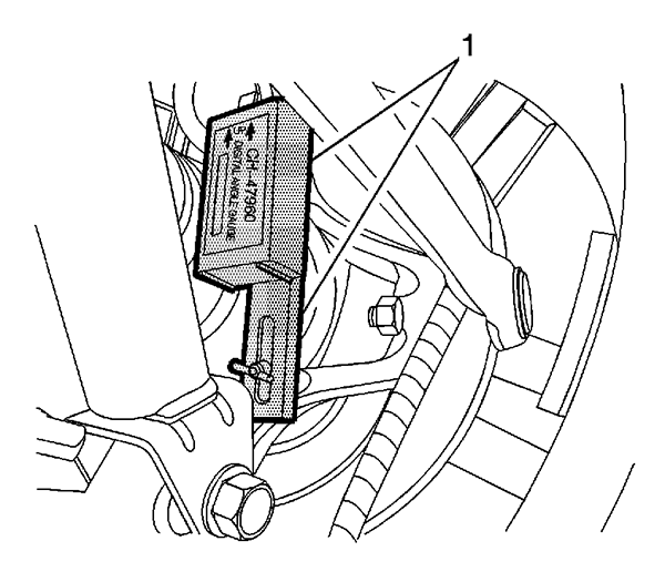

Before installing the gauge mounting adapter to the knuckle, use a soft nylon bristle brush to clean debris from the adapter holes.
Install the digital angle gauge and the gauge mounting adapter as a unit to the knuckle. (Fig. 10)
F10 angle gauge installed
Use an alignment machine to measure rear wheel camber and the digital angle gauge to measure rear wheel caster.
Rotate the cam bolts to the required camber and caster settings, maintaining the settings while tightening the cam bolt nuts.
