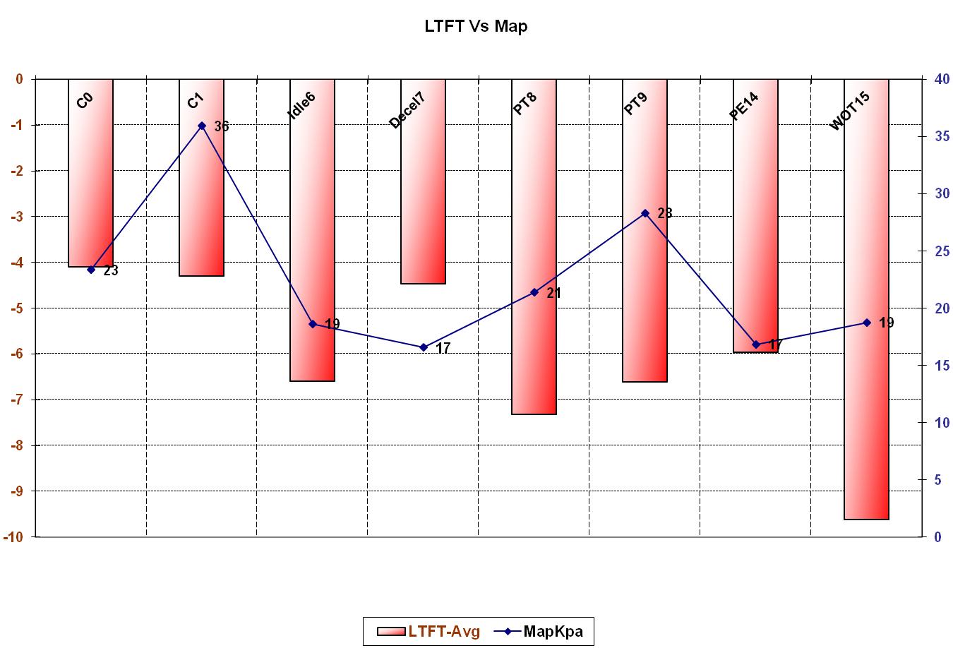

We did some testruns while recording the OBD-II data and as seen with other C7 Z06s was biased by GM as to rich due to Ethanol gas Testruns were done at 3,800 feet elevation
Being he lives in 6,000 feet plus elevation made it even richer and with Z06 having about 6,000 miles on it was clear how rich as all four muffler tips were covered in rich carbon buildup
Scanner data showed the Long Term Fuel Trims (LTFT) peaking as much as -12% rich, even too rich under hi boost around 135 MPH

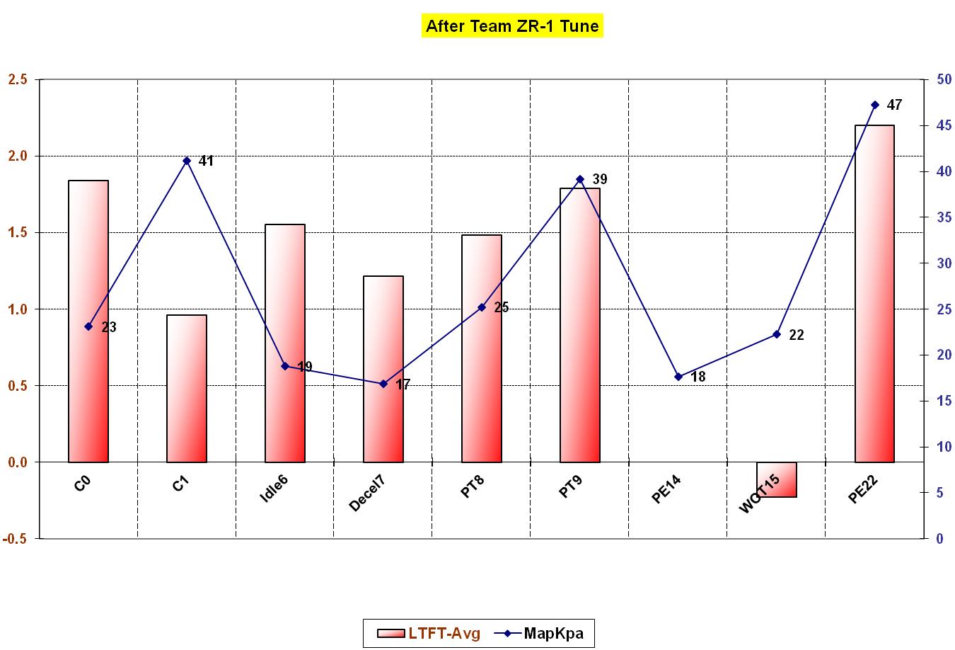

We leaned up the fueling trims and even with more timing added after the custom tune we did some hard pulls and all looked good with LTFTs about 2% lean

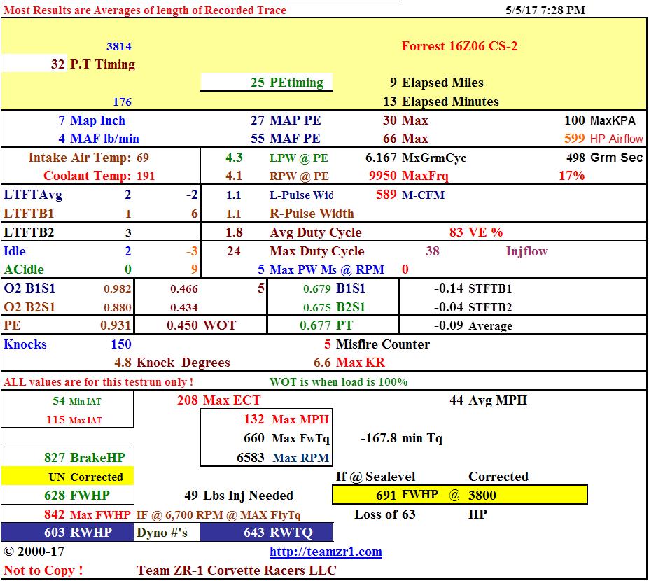

Flywheel horsepower gains reported close to 700 with very little engine knock with leaner AFRs
Results shown below is after our custom tune and the LTFTs before and after out tuning
