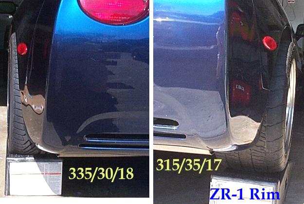

I wanted to run the BFG drag radials that are on rims from my ZR-1.
I installed one of them on the rear :
[Linked Image]
As you can see the tire on the right sticks past the rear quarter panel by about 3 inchs at the bottom and about 2 inches at the top.
Thus the stock ZR-1 rims do not have enough offset to be used on a C5.
John
