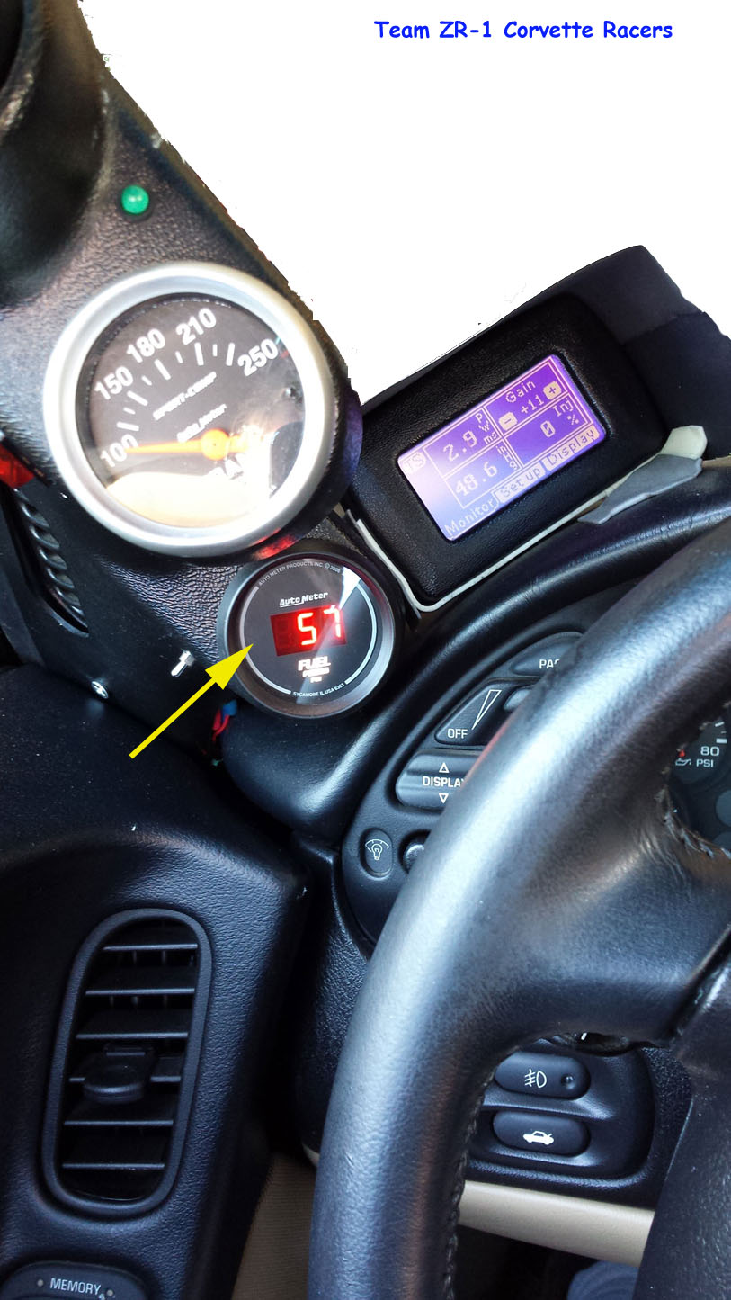

Late this spring got the 1999 Corvette out of storage as winter temps were gone, now around 65 degree days
Car had been sitting since late fall so time to get a testrun on it and check everything out
About 5 miles down the road I noticed the electronic Autometer fuel pressure gauge ( $288 cost) reporting fuel rail pressure going as low as 54 PSI
The GM specs for fuel system functions from 55 to 61 PSI so 54 PSI bothered me as in hotter weather that would be lower and cause high lean conditions
Tried the easy swap first, bought and replaced the fuel filter / regulator, did a testrun and still Autometer reported as low as 54 PSI

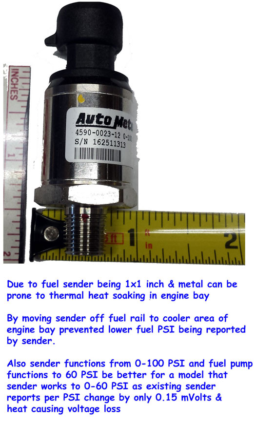

Now I suspect the almost new Autometer fuel pressure and gauge, this is a electronic setup, only operates from 0.5 to 4.5 Volts and being Autometer's specs is gauge functions from
zero to 100 PSI that means small amount of mVolts per PSI, fuel pump functions +/- 2 PSI of 58 PSI means the gauge operates in less then about 1 volt, no margin of error for and degrading or drifting.
It dawned on me that the gauge reporting was higher when engine was cold and then values dropped as engine got to operating range where in this Corvette is
185 degrees coolant temp as that is what the Tstat is
Autometer sender is made if thin metal and only 1" by 1" in size.

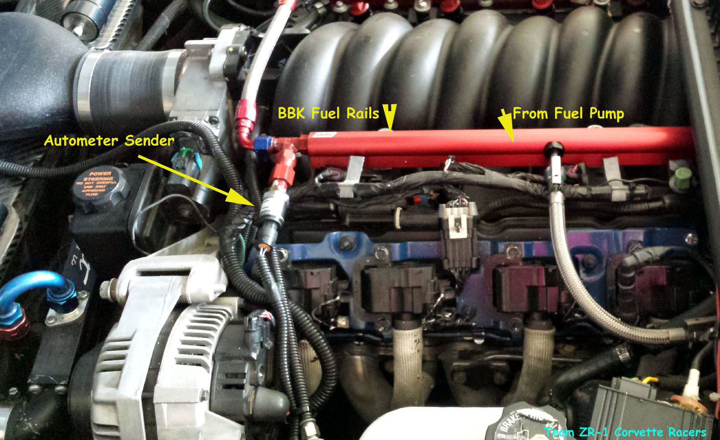

It mounts to a fitting on fuel rail which of course is at top of engine and where it would be the hottest
Ran some cold morning testruns and then later in 90 deg weather and was clear all along the sender was at fault
Contacted Autometer's support who told me that they only warranty this $288 product for just one year sex
I then sent a full report with findings to Autometer and got an email from someone in their marketing group
He then sent me a new sending unit free of charge
Installed and tested it to get about the same results !

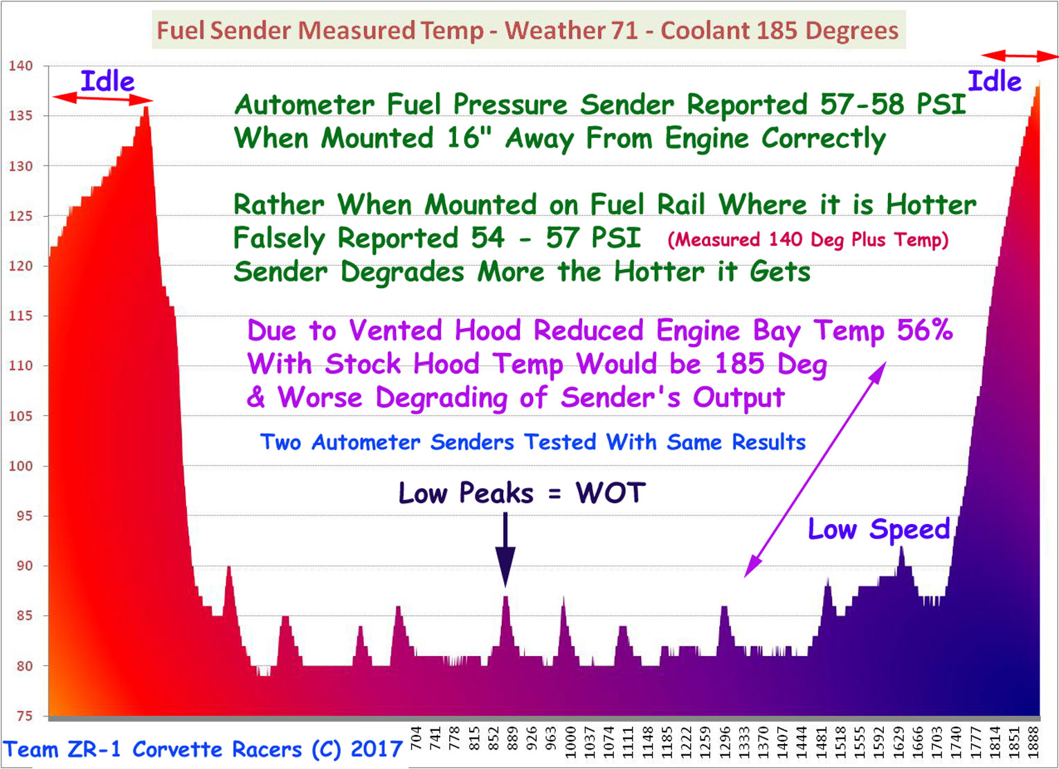

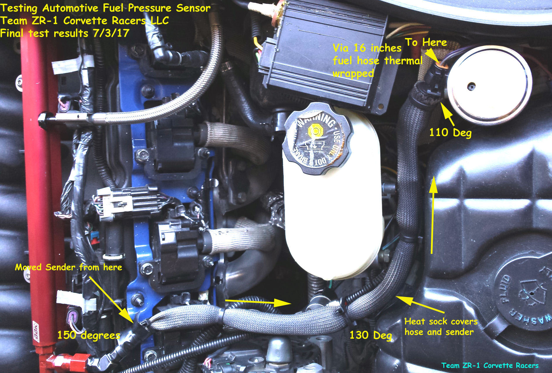

So now I start doing thermal testing using a J type probe to a Pyrometer, doing testruns and mapping thermal values that was recorded live by laptop software
Found is when sensor is mounted to fuel rail after testrun measured around 130-140 degrees
Then remotely mounted the sensor 16 inches away from engine, close to firewall and did testruns
As long as the sender measured less then 120 degrees, the PSI output it reported was closer to correct
Then dawned on me of another testcase, the Corvette has a custom hood, with scoop and openings for bringing in colder airflow and extracting hot air out
When testing first started the opening were set to reduce airflow about 60% and why testing above, sender was about 130ish deg rather then 185 deg of Tstat
So final testcase, scoop openings set to allow maximum flow, sender still 16" away
Sure enough in several daily testruns over 4 days of testing example below, Cold start gauge reported 59 PSI, after few minutes at idle reported 57 PSI
During several 25 mile runs, in 70 and 90 deg weather gauge now reported correctly staying at 57 PSI most of time, decel a bit and up to 58 PSI
Not once when in colder temp did the gauge report less then 57 PSI so without a doubt the sender degrades output (mVolts) around 120ish degrees and worse by 140 deg.
With the hood scoop fully functional and weather was 70 degrees, as long as car was doing over 20 MPH the sender measured only about 10 degrees higher
and temps only spiked when at idle at around 130 degrees but as soon as car above that 20 MPH the sender temps would drop again.
Only slight increase in temps during WOT.
All this testing was repeated to both of the Autometer fuel pressure senders I had with repeated results

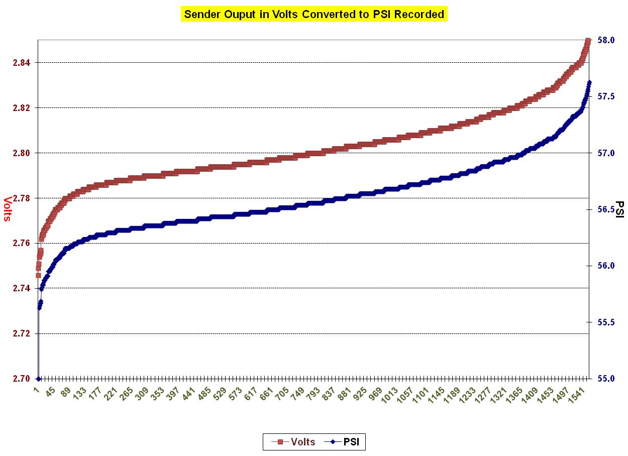

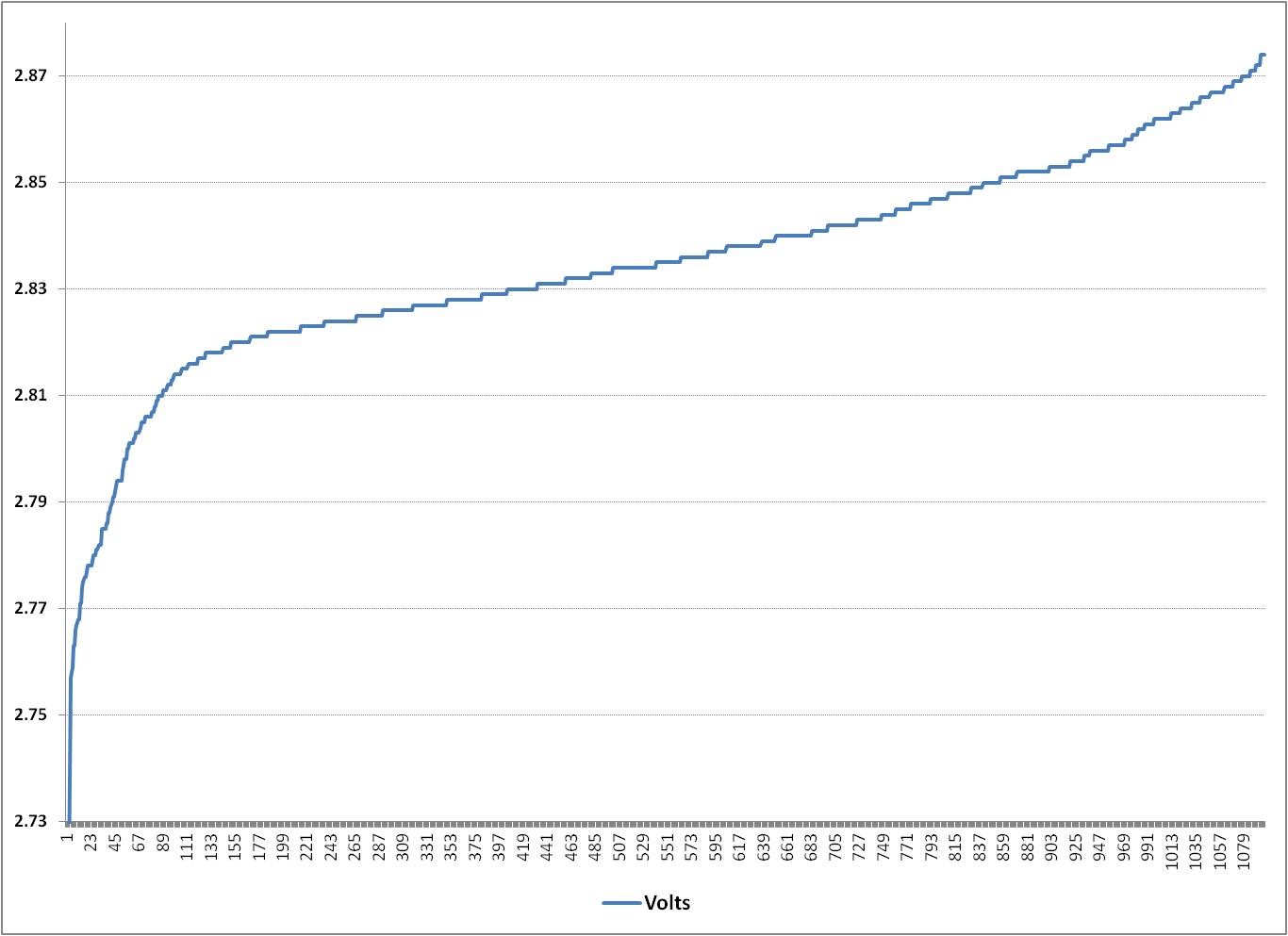

In the graph below was recording the output of the sender with a digital voltage meter which outputted the voltage values during a testrun to a laptop as a recording
which then is imported into Excel spreadsheet.
As seen the sender was reporting as low as 2.72 volts which equals 55 PSI and as high as 2.87 volts, i.e 59 {SI
This was when sender was cold gauge reported 59 PSI but as sender got hot output was degrading, reporting 55 PSI when in fact
when sender is mounted to a colder location the real reading is 57-58 PSI

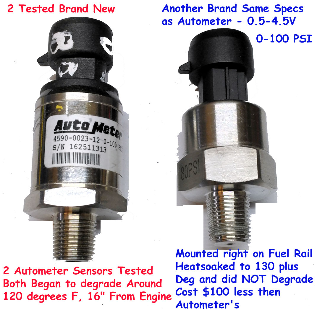

Two Years have passed since Autometer's engineering and support group told me it was impossible that their fuel pressure sensors for there digital
gauge cannot be faulty.
Basically telling their customers that after spending around $300 for their product and screw warranty for functioning incorrectly that there is no recourse
in getting their product that works as their marketing claims

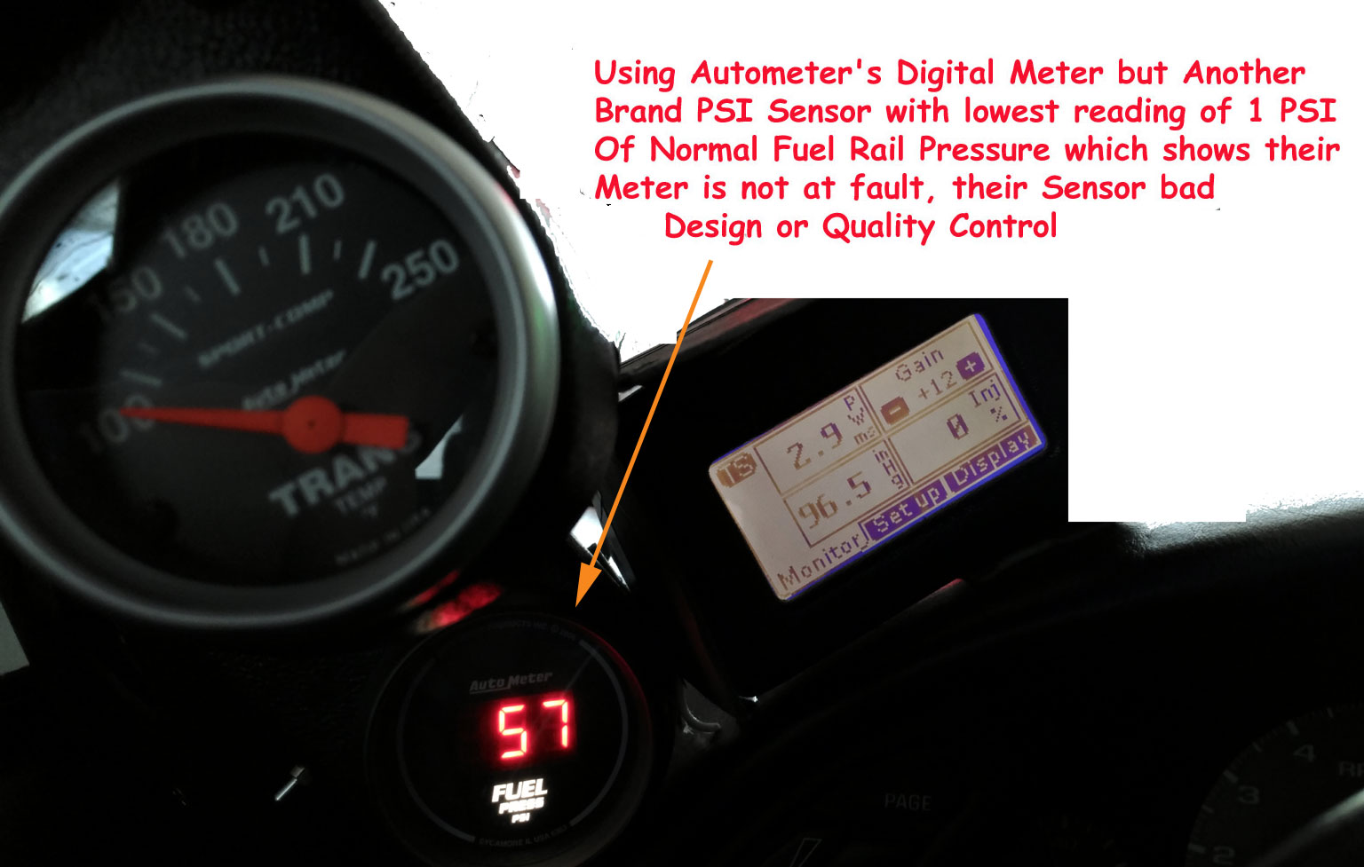

This August 2019 I decided to give it one more shot in calling Autometer and again explaining how their fuel pressure sensor degrades over normal or even
less engine bay temp and was again told their products design or quality do not degrade with less then 125 degree engine bay temperature
I spent around 1 hour on hold to even get to talk to anyone there.

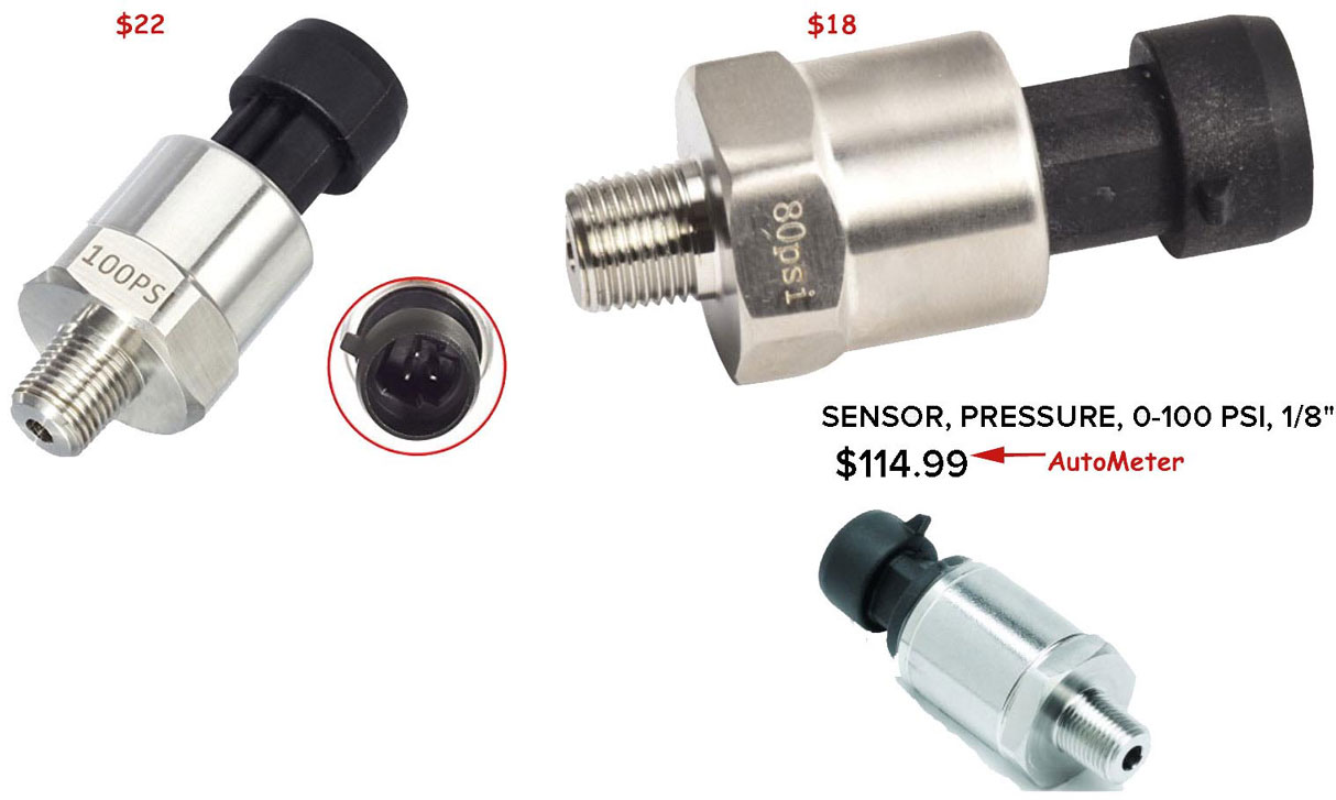

Autometer's 0-100 PSI spec'd to function from 0.5 to 4.5 volts alone costs $120-130, that does not include anything else.
I searched internet and found two other brand sensors with the same specs as Autometers
Considering the hood on my Corvette has multi opening to bring in colder air and extract hot air and has a larger flowing radiator with a 185 deg Tstat and
a heat exchanger with 7 quarts of synthetic oil the engine bay is cooler then a normal car yet Autometer sensor still degraded the output to their own gauge
One cost only $18 and the other $22, seems one hell of a profit margin for Autometer
I tested both mounted 16 inches from engine which is cooler then top of engine where last I located Autometers which still degraded and incorrectly reported
out of spec fuel rail pressure
Neither of the two tested failed, even in 90 degree summer weather and even worse case with hood closed and engine at idle for 20 minutes

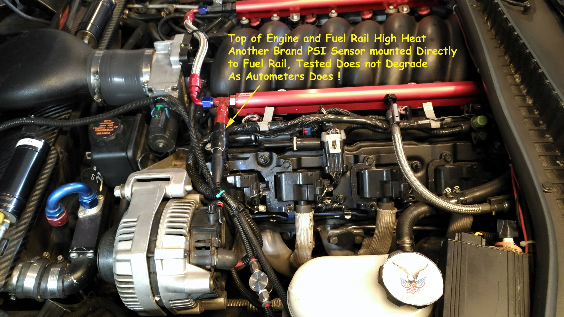

Then mounted these 2 other brand sensors directly to the fuel rail as shown below and again hard heat tested to where sensors shell reported 140-150 degrees
and at worst dropped 1 PSI where Autometer's reported as low as 54 PSI.

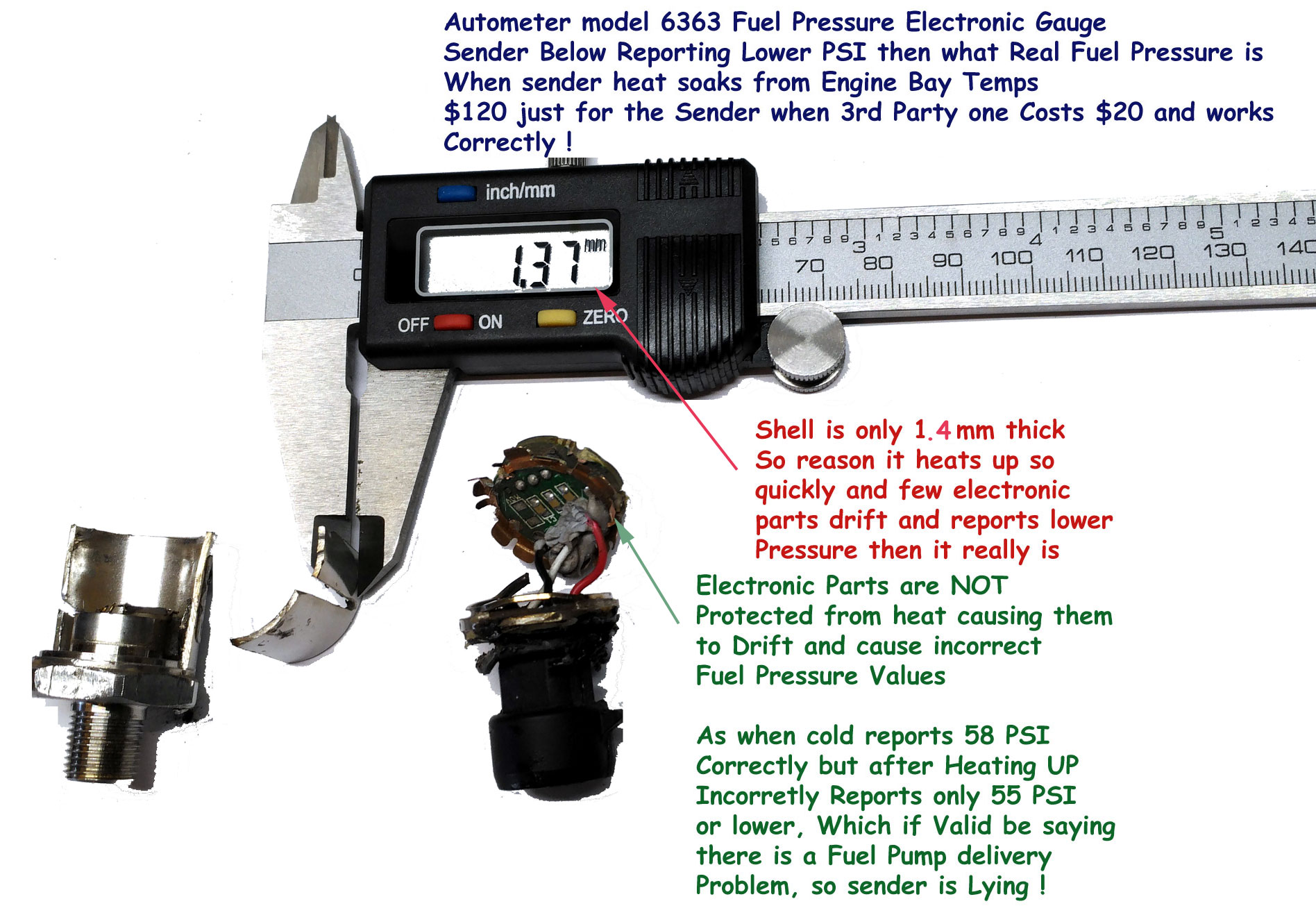

I took apart one of the 2 Autometer sensors, the shell (case) is only 1 mm thick so it cannot heat-sink very well and once heat-soaked the incorrect output values
(voltage levels) maintain and rest of that drive cycle reports PSI incorrectly
Once engine and bay are cooled down ( lower then 100 degrees) then their sensor again reports values correctly so
that shows the flaw is within their sensor ( or who they OEM them from?)
Being all these tests used Autometer's digital gauge and their wiring shows the design failure due to normal and even lower engine bay temps is directly
due to the design or lack of quality control of their $120 plus sensor sick
You would have thought their people would have wanted to use my testing to solve and better their product but instead they insisted their designs never fail
