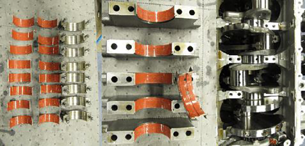

Crankshaft Wear
If end play is found to be out of specification, remove the engine and check for possible crankshaft thrust bearing or crankshaft. The crankshaft and bearings should not show signs of excessive wear. (Fig. 10) Inspect the thrust bearing for wear on one side and the crankshaft on the mating surface.
