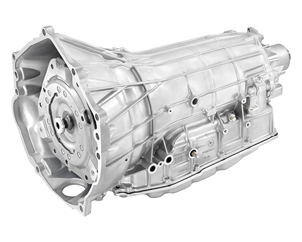

Harsh shifting conditions and delayed garage shift engagements may be noticed on some 2017 Colorado, Canyon, Express, Savana; 2016-2017 ATS, CT6, CTS, Camaro; 2015-2017 Escalade, Silverado, Sierra, Yukon Denali, and Corvette models equipped with the 8L45 or 8L90 automatic transmission (RPOs M5N, M5T, M5U, M5X). (Fig. 12) The harsh shift conditions may be caused by one or more clutch fill times not completely learned in the Transmission Control Module (TCM).
