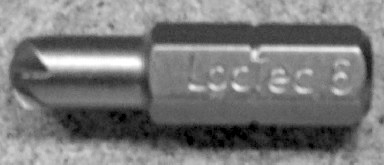

Tamper-Proof Drive Bits
The GR-6 bits in the Tamper-Proof Drive Bit Set (EN-50956-A) will install a fastener only, making it ARB compliant. The set includes three tamper-proof bits, and replaces the single bit (EN-50956) previously released.

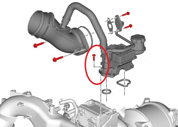

Service Examples
An example of where tamper-proof fasteners are used is the air cleaner outlet duct on a 2017 Spark equipped with the 1.4L gas engine (RPO LV7). The Service Information instructs to remove the air cleaner outlet duct by using a suitable tool to cut a slot in the tamper-resistant PCV bolt heads (1) and remove them with a flat-bladed tool. Discard the bolts after removal. Installing a new air cleaner outlet duct with the PCV tube and valves to the engine requires using the EN-50956 tamper-proof drive bit.
