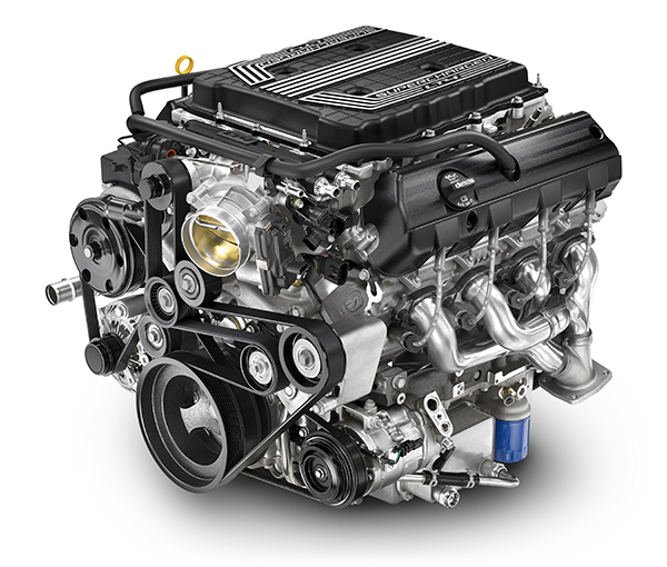

The 6.2L V8 engine (RPO LT4) available in 2016-2018 C7 Z06, Camaro ZL1 and CTS-V models features an Eaton Roots-type supercharger (Fig. 6) that creates a maximum boost pressure of 9.7 psi. The air entering the supercharger is cooled by an integral intercooler to enhance the effectiveness of the supercharger. The intercooler uses conventional coolant in a system that is separate from the engine cooling system. It includes two charge air coolers/heat exchangers, a water manifold assembly, and a variety of sensors to monitor air temperature and pressure.

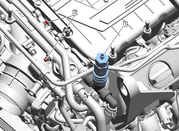

The drain plug for the Charge Air Cooler radiator is located behind the radiator lower baffle. Drain the system by opening the two air bleeder valves on the supercharger water manifold. Be sure to measure and record the amount of coolant drained.
Close the two bleeder valves and tighten to specification. It’s critical that the system be completely free of air to prevent Charge Air Cooler pump noise and loss of system performance.
Install the GE-47716-30A Vac-N-Fill Green Colored Adapter (Fig. 7, #1) to the Charge Air Cooler quick connect fitting. Next, follow the instructions in the appropriate Service Information to attach the GE-47716 Vac-N-Fill tool to the adapter.
Use a 50/50 mixture of DEX-COOL coolant and clean, drinkable water. Always use more of the 50/50 mixture than necessary to eliminate air from being drawn into the cooling system. Test the concentration of the coolant mixture using the GE-26568 Coolant and Battery Fluid Tester.
