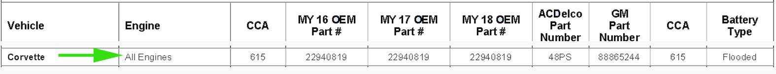

GM has released an updated Original Equipment Batteries Part Number chart for use when testing batteries using the EL-50313 GR8 Battery Tester/Charger. The chart includes cold cranking amperage (CCA) ratings and identifies the type of battery. Refer to Bulletin #15-06-03-002L for more information.
Correct battery CCA ratings and battery type are critical for proper test results when using the EL-50313. Access to the battery specification label, which contains the OEM part number and CCA rating and type, may be difficult without removing the battery. Use the updated chart for the ratings and part numbers needed to set up a proper battery test.
Electronic Parts Catalog Part Numbers
If a battery needs to be replaced, the correct ACDelco battery warranty replacement in the Electronic Parts Catalog is designated by the “Original Equipment Replacement” note in the description field. Bulletin #15-06-03-002L has additional details about how to provide feedback on battery part numbers.
