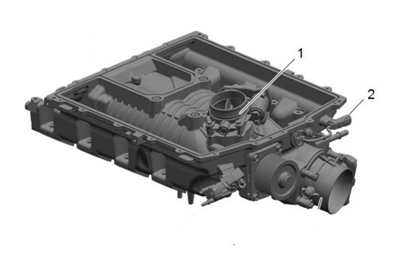

The electronic compressor re-circulation valve, or supercharger bypass valve actuator (Fig. 28, #1) on the LT5, is very similar to a standard electronic throttle body used for diesel engines. It provides fully-variable boost pressure control with none of the restrictions known to pneumatically-controlled re circulation valves.
During moderate to heavy acceleration the bypass valve is commanded near closed. As the desired throttle position increases, the throttle valve is commanded wide open and the Electronic Control Module (ECM) modulates the supercharger bypass valve position to control boost pressure. When boost is not desired, such as at idle and partial throttle cruising, or on deceleration, the excess air that the supercharger produces is recirculated through the open supercharger bypass valve and the passage between the intake manifold and the supercharger inlet.

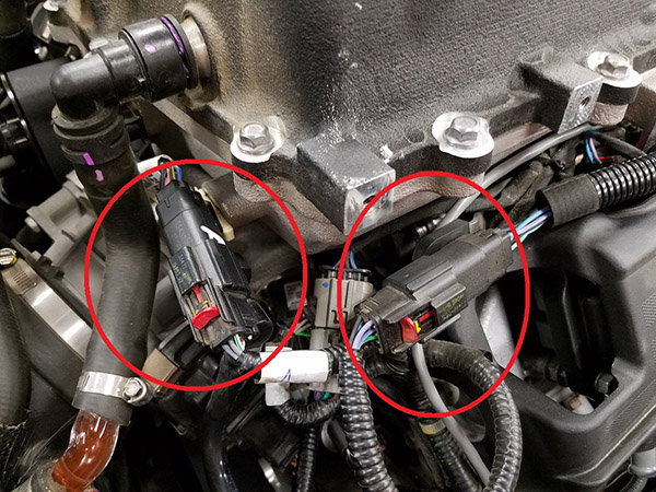

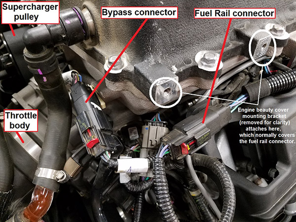

The supercharger bypass valve connector is located on the front of the engine just above the throttle body. The bypass valve connector should not be confused with the nearby fuel rail connector, which is located under the intake manifold cover. (Fig. 29)
The connectors are interchangeable. (Fig. 30) Be sure to locate the correct connector when performing any repairs.
