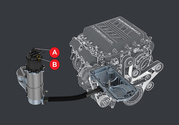

2014-2019 Corvette models equipped with the 6.2L V8 engine (RPO LT1, LT4, LT5) with a dry sump oil system (RPO Z52) require an engine oil change immediately after the 500 mile break-in period.
If the vehicle is driven continuously at a high engine speed with the first factory oil fill, silicone sealants in the engine’s gaskets may degrade the anti-foaming properties of the oil.
This may lead to oil leaking out from the air cleaner assembly due to the oil foaming condition. The oil foam does not affect the engine’s durability, but changing the oil at 500 miles will help prevent oil foaming in the future because the silicone sealants are removed with the original oil.
The dry sump engine oil tank fill (Fig. 32 A & B) are located on the passenger-side of the engine compartment
Once the break-in oil change is performed and the Oil Life Monitor is reset, owners should follow the Oil Life Monitoring system for all future oil change needs.
