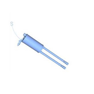

The GE-52079 Coolant System Fill Tool (Fig. 7) and GE-52079-10 Coolant System Fill Tool Adapter (Fig. 8) are required to fill the charge air cooling system on the C7 Corvette ZR1 (LT5) and Z06 (LT4). The Vac-N-Fill machine must be used in conjunction with these tools.

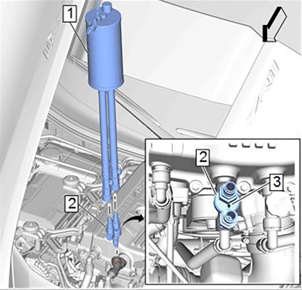

The GE-52079 Coolant System Fill Tool (Fig. 9, #1) is designed to purge all air from the system after service, which will achieve a complete fill. This is very important because any air left in the system will have detrimental effects on vehicle performance (i.e., loss of horsepower).
Filling the System
The GE 52079-10 adapter (Fig. 9, #2) plugs into the coolant system quick connect fill port tee. It does not matter which of the fill port tees are used; however, the arrow on the adaptor must point out and away from the engine (Fig. 9, #3).

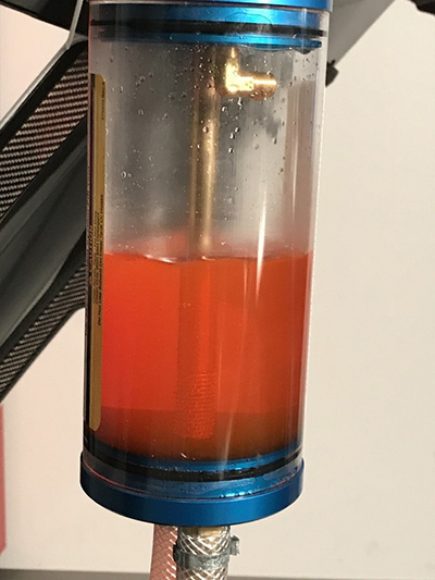

Coolant will continue to enter the GE-52079 reservoir and de-aerate the vehicle’s cooling system. The measurement gauge on the side of the GE-52079 reservoir can be used to monitor the decreasing level of the coolant inside the reservoir. When the system has stabilized at a specific level within the reservoir and no more air bubbles are visible, the system is considered full. (Fig. 10)
