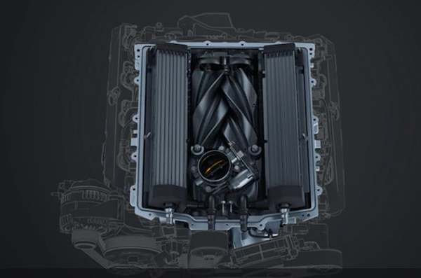

The supercharged 6.2L V8 engine (RPO LT5) in the 2019 Corvette ZR1 uses five charge air cooling radiators. Behind the front fascia, there are three charge air cooling radiators; one in the center and one in each corner. There are two more within the supercharger assembly (Fig. 6). Two on-vehicle electric pumps are used to pump coolant to the driver-side port and the passenger-side port of the supercharger.

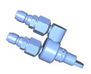

GE-26568 Coolant and Battery Fluid Tester GE-47716 Vac-N-Fill Coolant Refill Tool GE-52079 Coolant System Fill Tool GE-52079-10 Coolant System Fill Tool Adapter
The GE-52079 Coolant System Fill Tool (Fig. 7) and GE-52079-10 Coolant System Fill Tool Adapter (Fig. 8) are required to fill the charge air cooling system on the C7 Corvette ZR1 (LT5) and Z06 (LT4). The Vac-N-Fill machine must be used in conjunction with these tools.

The GE 52079-10 adapter (Fig. 9, #2) plugs into the coolant system quick connect fill port tee. It does not matter which of the fill port tees are used; however, the arrow on the adaptor must point out and away from the engine (Fig. 9, #3).
