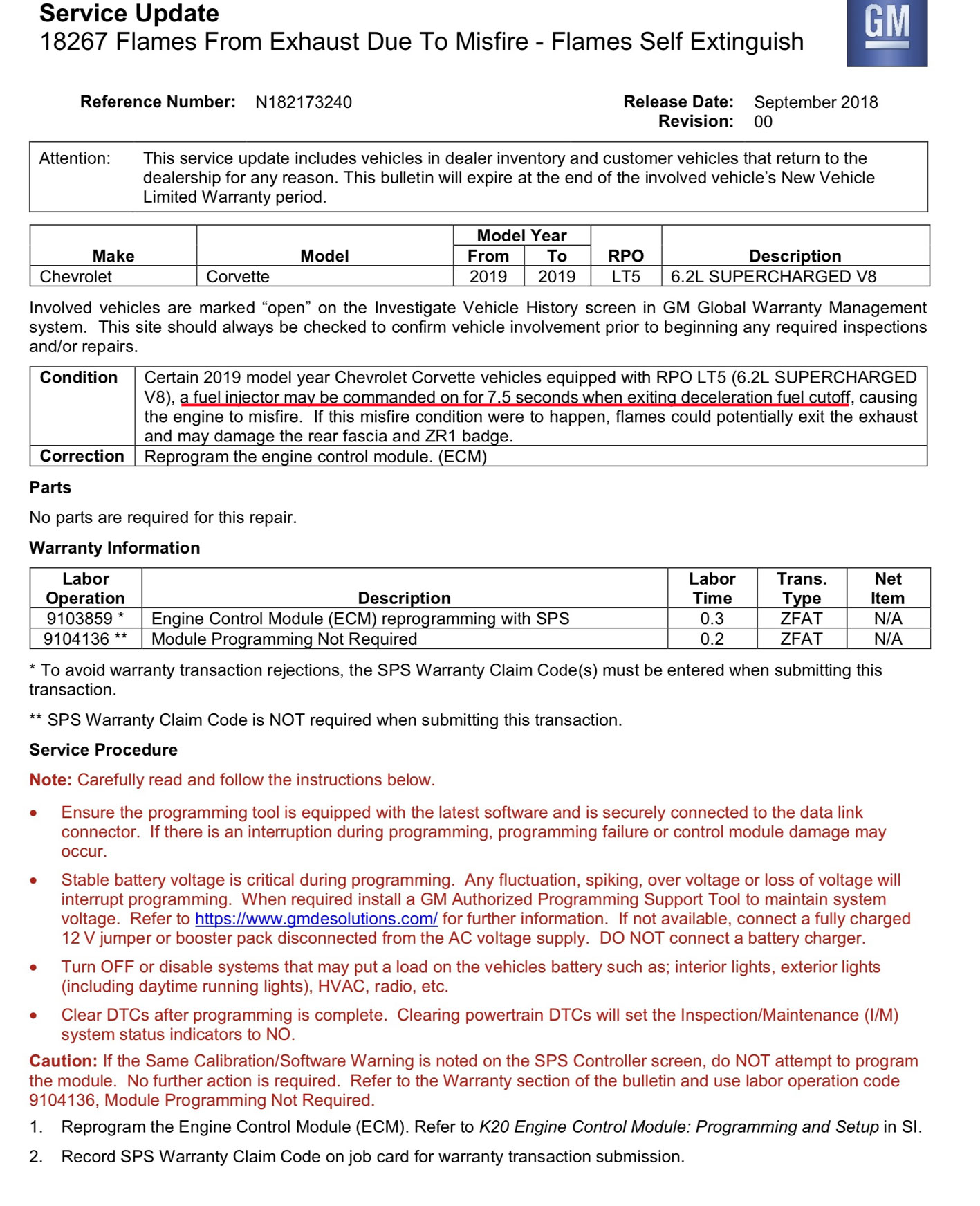

See C7 ZR1 Blow Flames out Ass & How to Stop it
Posts: 6,020
Posts: 6,020
2019 C7 ZR1s have a issue ( but is cool) that on Decel (lifting off gas pedal) can shoot flames out exhaust
If you want that to stop refer to this GM TSB which is a software update to PCM
Listen and see this in all the glory !
